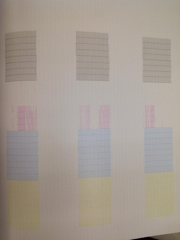

Hi Guys,
This morning I just started printing on my Mimaki JV3 160SP, My prints came out very bad and I thought it's got to be my head not spraying ink. I checked and saw the Magenta head was not coming out properly.

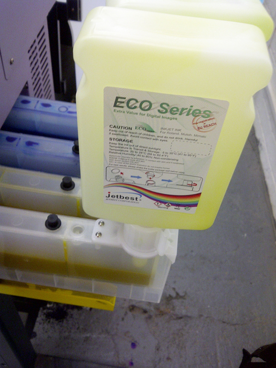

A week Before I changed the inks to bulk in system and was working fine. I also flushed the machine.
This morning I have done so many cleans, to Nozzle washes to cleaning the capping station. I am stuck and biting my fingures away as jobs need to go out. :banghead:
Soo please please advice me what this can be, OO I have added some pictures that shold help you guys to understand more.

Vinylman
Just wondering if switching to your bulk ink system is still looking like a money saving idea right now?
That being said, have you tried attaching a syringe to bottom of the docking station below the magenta head, and slowly drawing ink through the print head with the ink valves open from the bulk ink system to the heads?
Barring a failing print head, this many times will clear a slightly clogged head faster than the traditional print head cleanings that are done with your software. BUT only do this IF you are familiar with the technique IT CAN CAUSE PERMANENT HEAD DAMAGE IF DONE WRONG! Ask questions BEFORE PROCEEDING if you are unsure.
Marcis Lusis
it seems the air comming in ink tube..follow steps
1. check u have no air bubbles in both magenta lines
1. cut of 5mm ink tube before both magenta dampers and conect them back (probbaly u hve to feed forward tubes manualy)
2. change damper
3. check plastic head mainfold

artbot
you have to diagnose it. put the black ink lines/dampers onto the magenta manifold. do a normal clean or pull lightly at the waste line. then to a test pattern. if you get black at the magenta head, they you have an issue from the dampers back. if black doesn't work at that position, then you have a capping station issue. do this first always when you see this come up.

Hey guys,
Just to let you know, the tech guy came and sorted the issue out in 15mins. He changed the dampers and used a syringe to bottom of the docking station and pulled the ink through. This was a learning curve for me.
Thank you very much for your time and help. Really appreciate it!! :D
artbot
if he pulled a vacuum at the waste line first he might have been able to determine if there was vapor lock inside of your head. and your dampers could have been fine to go for the next year or more. this type of stuff will happen to your printer on a regular basis. i encourage you to learn how to fix these "unbroken" issues in the future.
