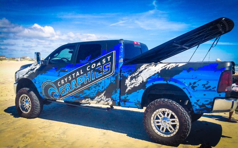

This is my truck for the shop. It's a matte black wrap, with Avery blue chrome and white reflective overlays. We laminated the chrome. It is tougher to work with than regular vinyl, but you just have to get used to its properties and limitations. I know everyone might not like the design, but it gets a lot of good attention. All of our other shop vehicles are much more simple, but we just wanted to have fun with this one.

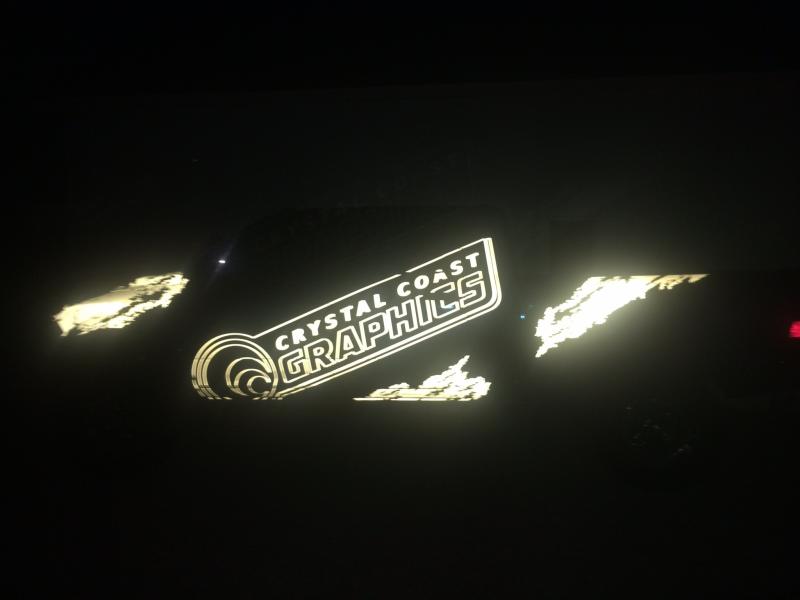

Here is the only one I have. The name stands out well at night, but the front and back white overlays look just random. Wish I had thought out the night view more than I did.

rjssigns
Love the truck!:thumb:
Gotta ask how much of a beast was it to apply the cut chrome?
It really wasn't that bad. The flat areas went on fine, then on the curves like between the cab and bed, we just removed the transfer tape, and applied without it. This way we could stretch it a little when we needed to. That is pretty much how we did all of the curved areas. Like i said, once you learn the limitations of the chrome, you just work with it. It is definitely more challenging then normal wrap vinyl, but not such a big pain that I wouldn't do it again.
