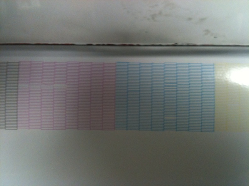

I know this gets covered often and have done a search. For what it is worth I have done several hard, soft, normal cleanings, I parked the heads overnight to soak and it seems to have gotten better but I am still missing some nozzles and have some that are bent or (deflected?)
If I run on 8 pass it prints pretty good, 4 the banding or horrid. I am just trying to get it back. I have been told it could be a bad damper as well as capping station.
Any ideas or anything else I should try?

Sorry for the bad pic. All I have.

I only see two nozzles that are missing. The deflections should clean up. The one's not printing are the one's to worry about.
You'd be advised to replace both the damper and capping station. Neither are terribly expensive (compared to the print heads). The dampers are the last line of filtering for anything that might clog your head. They may be full of small particulate. The capping station may not be sealing properly to allow for a proper cleaning.

Ditto on the soaking/nozzle wash. Looking at your pic, to me it looks like you need to adjust alignments, they look like they are printing on top of each other (Could just be the picture).
