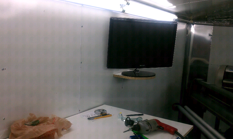

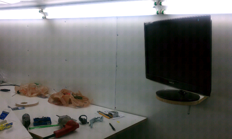

Table ready, primary monitor needs some bolts
