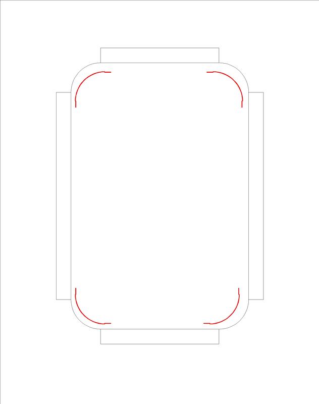

you can make it have rounded corners and make it a pan. you just have to make the sides have flaps to the depth you want and then patch in the corners with strips with bends shallow enough to fit behind the tabs and bend to the contour of the corner.
attachment.php
like this, where the red would be the scabs.
