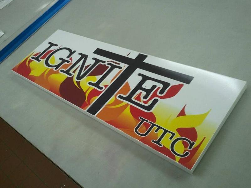

I make 4x8's all the time with 0.040 I bend a 1" lip on them and install them on angle brackets, that way screws are not in the face, they are on the top lip and bottom lip, out of site. I also glue foam inside this to get the wave out of it. Pan Box sign is what I call it... something like this (2'x4')

Moze

I would do this. ^

A brake works better than a hammer....LOL yes I have a pretty heavy brake I do it on. Most heating and cooling places have them if you don't have one. FYI, a siding brake isn't heavy enough.
Except that's not a flush mounting.
I would call this flush, as opposed to sticking out. It is flat against the wall, and looks like an inch thick sign.
16guage steel rated break will do .063 and .080 aluminum 16 guage steel is basically equal to .100 aluminum in terms of cutting and breaking.
