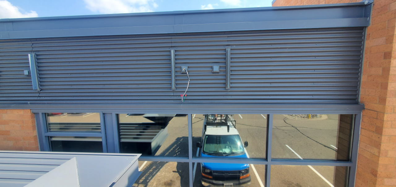

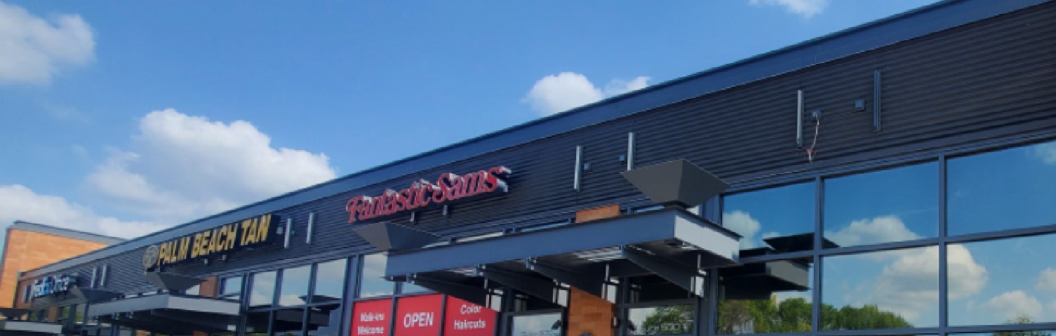

Can anyone tell me how I would mount raceways on the existing wall brackets? And would this only allow me to do one raceway? Our client will have 2 lines of text so they will need 2 sets of raceways - similar to the example mockup attached.

you do not need 2 sets of raceways, your art is showing the capsule attached to main copy by hanging under it, you should be just fine. Open top of raceway and screw into channel on building using large taps screws. Thats actually a good idea for a storefront to keep from getting a million holes in fascia.
