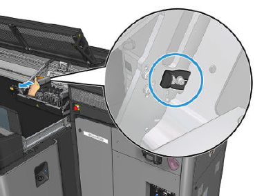

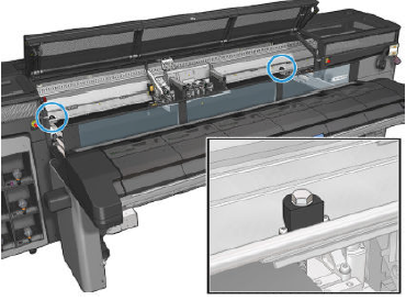

I would definitely bolt down the scan beam to the frame, there's bolt holes on both sides of the belt for it. Must be lowered down to bottom position before doing anything. You should also lower the heater to bottom position.
Carriage might have the lock for it still on it. That has multiple holes to choose where you want to stop it. Or just use imagination if you don't have it.
Take out the printheads (or don't if you lock the carriage on top of the caps). Depressurize air system and disconnect large ink tanks as well as intermediate tanks.
I would somehow try to secure the heater as well but not so easy without the proper brackets. Use imagination again. Remove the displays and PC.
There's no problem for it to be offline couple days even a week, it will be fine. Just shake the white inks before you start it back up and let it cycle the ink for a day.
Shutting it down for a day is your smallest concern, trust me. Just take your time, do it proper, take two days.
Personally I will always use the brackets that come with the machine to bolt down the beam and the heater but really if you take it easy it's not that bad. I'm just giving you like the minimum that should be done.
If possible I would use a large forklift. You can lift it up from the middle bottom beams.
