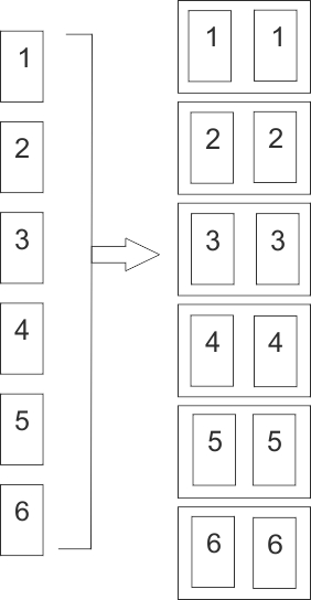

Have searched the forums, net and everywhere but always end up on a dead end. I have a simple task that is hard to solve apparently:
I have a PDF file with let's say 72 pages.
I want to print on a standard printer (letter size for example) a paper that comes out with 2 copies on one page, but NOT page 1,2 and another paper with 3,4 etc. side by side but one paper with page 1, 1 and another with 2, 2 and another with 3, 3 side by side so I could guilliotine cut them later on. Simply: two copies on one paper.
I've tried at least 10 different programs but none seem to do what I want, all just use the same "multiple page" function that is available in Acrobat.
I enclose a illustration of what I want to accomplish. So far I've had to manually insert a copy of the page in the PDF file, but this is very time consuming if you have 100's of pages...
If anybody have a suggestion for a program or something that could create this for a reasonable sum (I know maybe Pitstop could handle this but the license costs about a grand, I have about a 100$ tops in mind...)
Thank you very much!

Any RIP program that comes with your printer should be able to do this. Or, manually the easiest way I know is use InDesign & place the PDFs in there, shouldn't take 10 minutes.

Unfortunately I don't have a RIP to run these printers (Konica Minolta Bizhub:s), they have built-in RIP:s but don't have this function.
It doesn't take THAT long to do the same thing in Adobe as you guys suggest using Indesign for, but I just like the idea to have it automated. If you have about 100 pages it takes about 10 minutes, and you also have the risk of placing some pages wrong...

Thank you for your reply! I tried every setting imaginable with collate on or off, "offset" setting on or off, etc. etc., but to no avail. It prints exactly the same regardless of the setting. Sigh. I tried to discuss this with my printer techs and a competitors brand but neither had anything that could do this. One of the techs said that it couldn't bee that hard to write for example a script or something that inserts a copy of every page in a PDF, but I don't know...

OK, so I asked the guys that came in and one of them called up his head tech and he just said that the only thing is to buy a Fiery RIP for about 3-4k...
The collate function does rearrange the way the pages come out but not how they are placed on the paper...
kanini
OK, so just minutes after my previous post I got hold of one that knew of a program called FinePrint (49,95$) that works very well! You can select how many copies you want and with what imposition, e.g. how many pages you want on one page. At last! Thank you all for your replies anyways!
