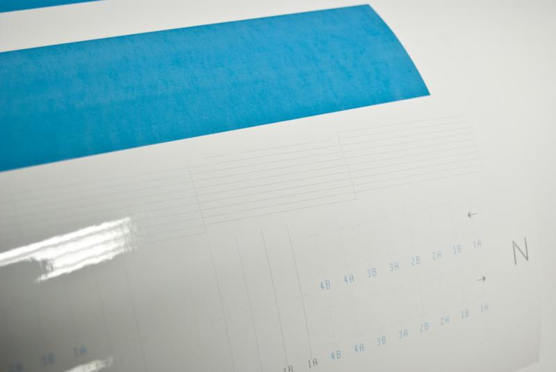

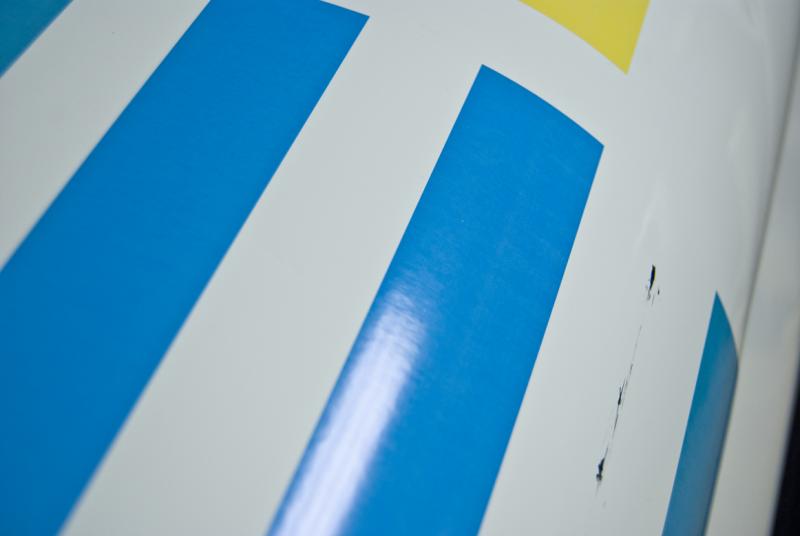

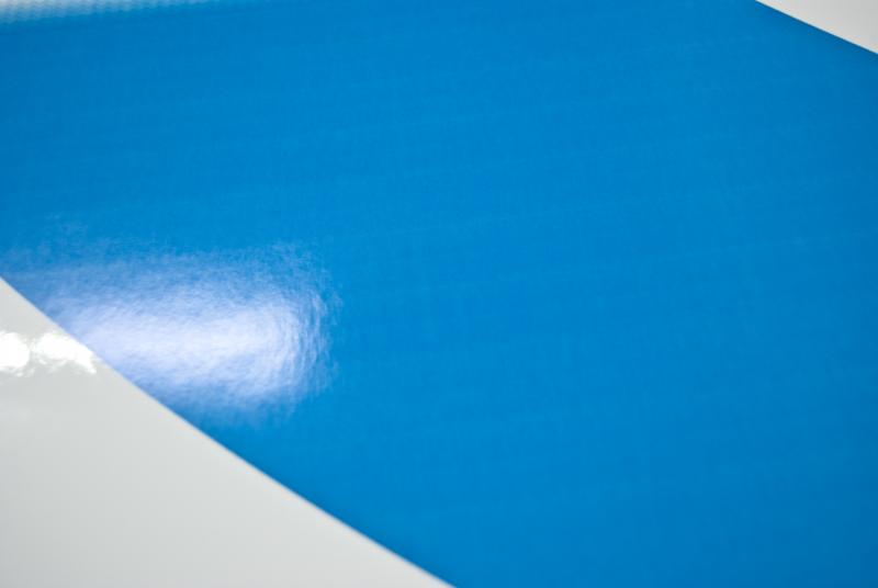

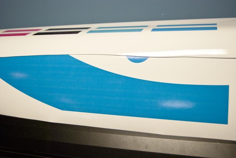

I attached some pics of the issue I am having along with the nozzle check results.. it was hard to capture the fading/banding in the print but I did my best. I am not showing any blocked nozzles in cyan, just a few missing in Black. I really haven't had many problems with this machine in the 5 years I have owned it.. and I would hate to start now. Looking forward to your response.. hopefully I can get this issue resolved ASAP! Thanks again for the help!

Can you show some of the test print complete showing CMYK as I can't see the complete set I can only see black and a little of the cyan?
It looks to me as if their is some out in the cyan as well am I correct?
Me personally if it was my machine and based on my experience I would at least change the head cable with an original mutoh one as this can deteriorate.
Also if money is no object I would replace the head but you may well have to do that anyway.
