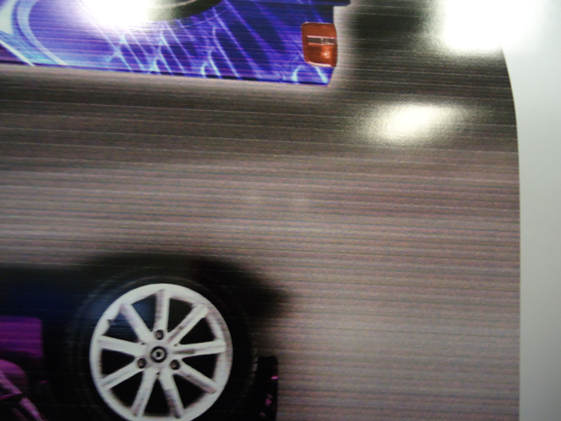

ok the colors seem to be back on track printing. I have ran several test with multi colored high res art. They look great for color except now I am showing lines through the prints. Would this be something on the print heads like lint or is it still working itself out. Check out my link to my dropbox of the last print. Any input is welcome.
Thanks!
Mark

Robert M
Maint station
Have you ever changed out the maintenance station. Sounds like the pump may not be pulling down waste ink and you wiper assembly may be full of dried ink.
fastlanesigns
I replaced it about 6 months ago and do weekly maintenance. It was suggested to flush the drain lines. I am not sure how to do that part and am researching it now. i am just grateful it is starting to get back to normal.
