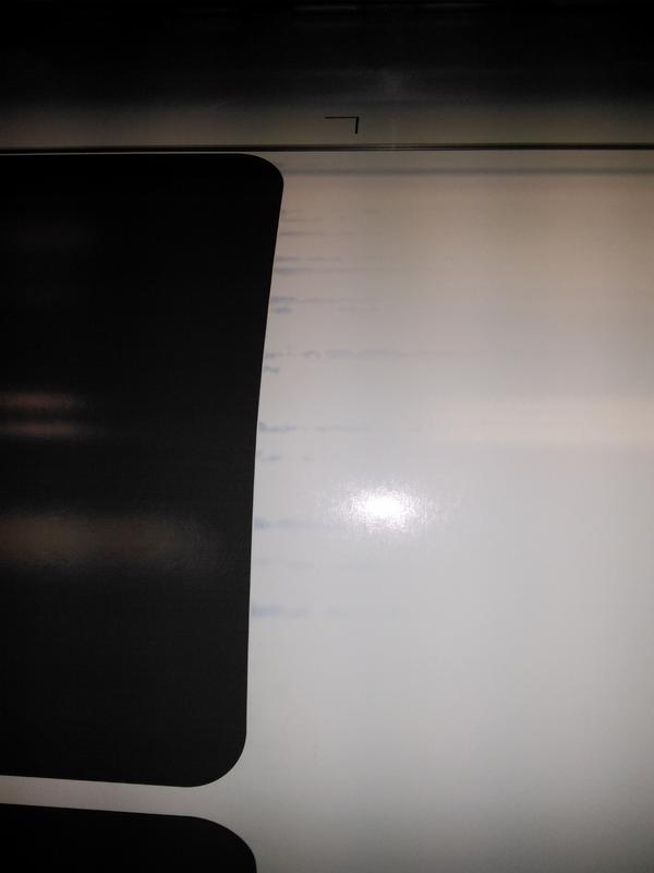

Hi everyone, I'm getting there weird blackish blueish marks on my prints. I was wondering if anyone knows what these are or how to fix this. Thanks. I will post a pic if I can figure out how

Check and clean the head and ramps either side.
Clean or replace the wiper
Clean or replace the cap.
If this doesn't fix the problem clean the encoder strip with denatured alcohol.
SC
Asuma01
Ive had this exact same problem in the past and it ended up being static electricity blowing ink droplets around.
We bought a humidifier (because I live in a dry climate), and I bought the wide format kit from www.stopstatic.com.
Also try a different roll of print media. Some brands have more static charge then others. I went from Arlon to 3M and had better results.
As far as cleaning the encoder strip. Use alachol and a lint free cloth and pinch the strip (gently) between the cloth and slowly and carefully move the cloth back and forth across the strip a few times. Or until the cloth comes up clean.
chrisphilipps
Merchant Member
+1 for Static. It could also be caused by having the printer in high head height on thinner media. If you are running it high and the media doesn't require it try switching it to the low setting.
