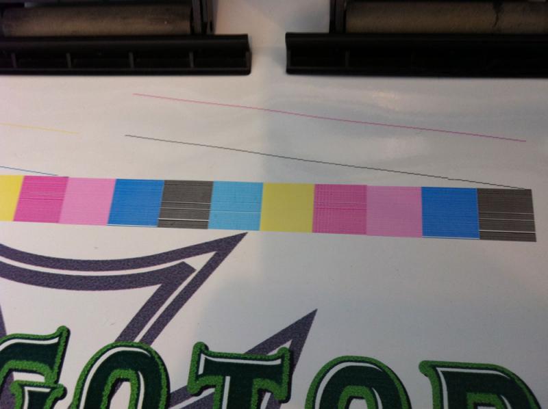

Ok! Got the new damper in, and it's holding ink! My nozzle check doesn't look half bad!
Last question: How do I align the heads on this thing? I notice that the heads are about 1 line different from each other.

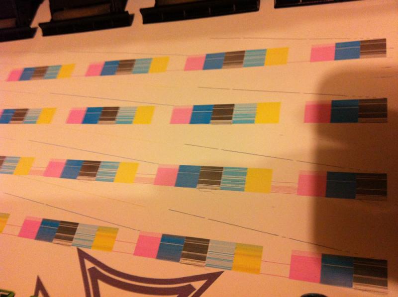

Also, here are my recent nozzle checks. So much better than they were! However, notice the tiny tiny lines? Is that normal? Or should each of those blocks be vibrant, solid color with no tiny lines?

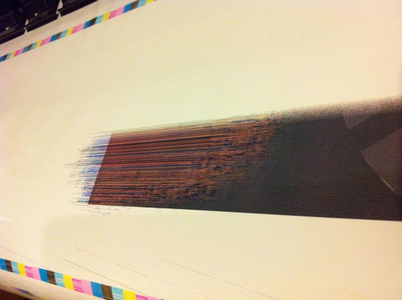

Ok... the Falcon started acting up again. I got black to come back, but then my printer started doing something weird as you can see in the first picture, and now the nozzle checks suck again.
Through this whole process, the printers clean cycle doesn't seem to do hardly anything to improve these nozzles.
Why was it cleaning up and now why is it bad again? I can haz start to make monies?
daenterpri
More effective in clearing nozzles than the system clean, is just letting it sit for a while. I let the printer sit for a couple hours and the nozzle check looked a little better, but still had missing nozzles.
Any ideas? Any other ways that I can tell if my problem is the pump?

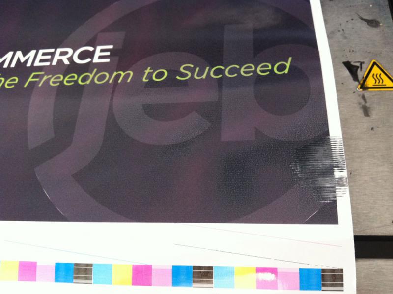

On this latest print, you can also see that I'm smearing ink. And you can also see that I have smudges of dark green in my print. Also, there are lines through it, it's not particularly clean looking.
Any ideas? I've tried a lot of things. I'm tempted to buy the refurb kit from CMYKParts.com and just refurb it all over again (it's been recently refurbished).
Any help would be greatly appreciated :)
