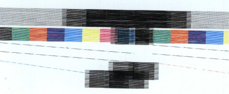

See attached photo.
Just today, my Mutoh Jr. started depositing 100% black ink in a certain area of the print path. It does this every time I print & it is always right around 2" x 5" from the bottom of the vinyl.
It is printing lines so I know it is not just ink spilling from the print head.
It also does the same thing if I do the print check so I know it is not a file/rip/pc problem.
This has never happened before - anyone know the problem?
Thanks
Mike

Rat_Fink
The only thing that I did before this started happening was & removed & cleaned the square thick absorbent material (the one before the wiper).
I have already tried to clean the encoder strip with no change.
Thanks
Mike

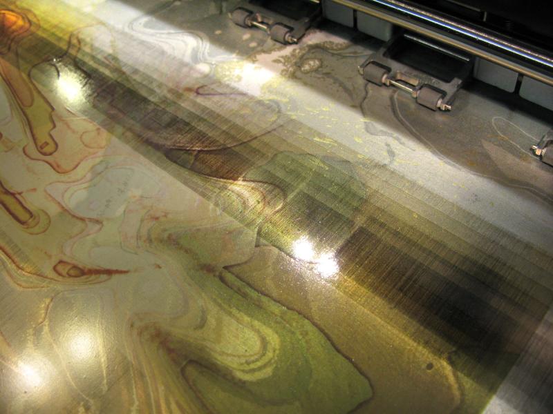

artbot
maybe ink leak or data ribbon loose
that is data/electrical
i'd first turn off the machine as a precaution to make sure you haven't sprung and ink leak at the head or slider board.... just a precaution, but if it is that 10% possibility, than you are risking major damage. after you are sure you don't have latent ink on your printer boards and or print heads, power down your printer and look for loose data cables. i had this happen to my printer and it disappeared as soon as i tightened my black head cable.
