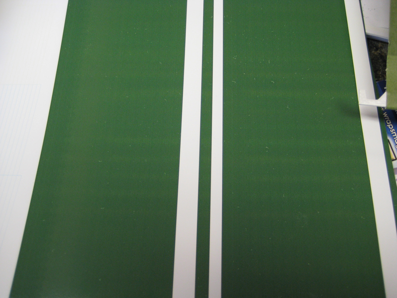

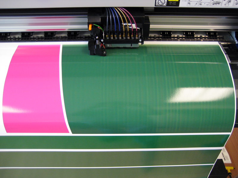

can anyone identify this problem? it seems to be happening in green (of course the color we have to print A TON of go figure). we have tryed heaters off, heaters on, cleaning the head, cleaning the rollers.. any silver bullet advice would be much appriciated!
thanks in advance.

just checked. same in both. we are printing on 180cv3 and using flexi if it helps.
gamerxr72
For the horizontal banding, it looks like it might be the way the material is wound around the core it came on. Try pre-feeding the material in a loop over the top of the roll with a lightweight core inside the loop to prevent a media slant.
You might also consider that at some point the material was left laying on its side and the pressure has left portions of the material with uneven thickness.

also seems to be happening more towards the head side of the printer not the far side.
P
ProWraps™
Guest
upon inspection, it would appear the platten heater is to temp in the middle, and no heat on the sides... especially the side that is banding the most.
any ideas? its a very noticable difference. the heat settings are what fellers recommends for 180c 40c pre, 42c plat, 50c post.

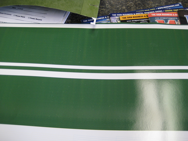

ugh getting even worse!
see attached.
nozzle checks are flawless and so are alignment checks...
