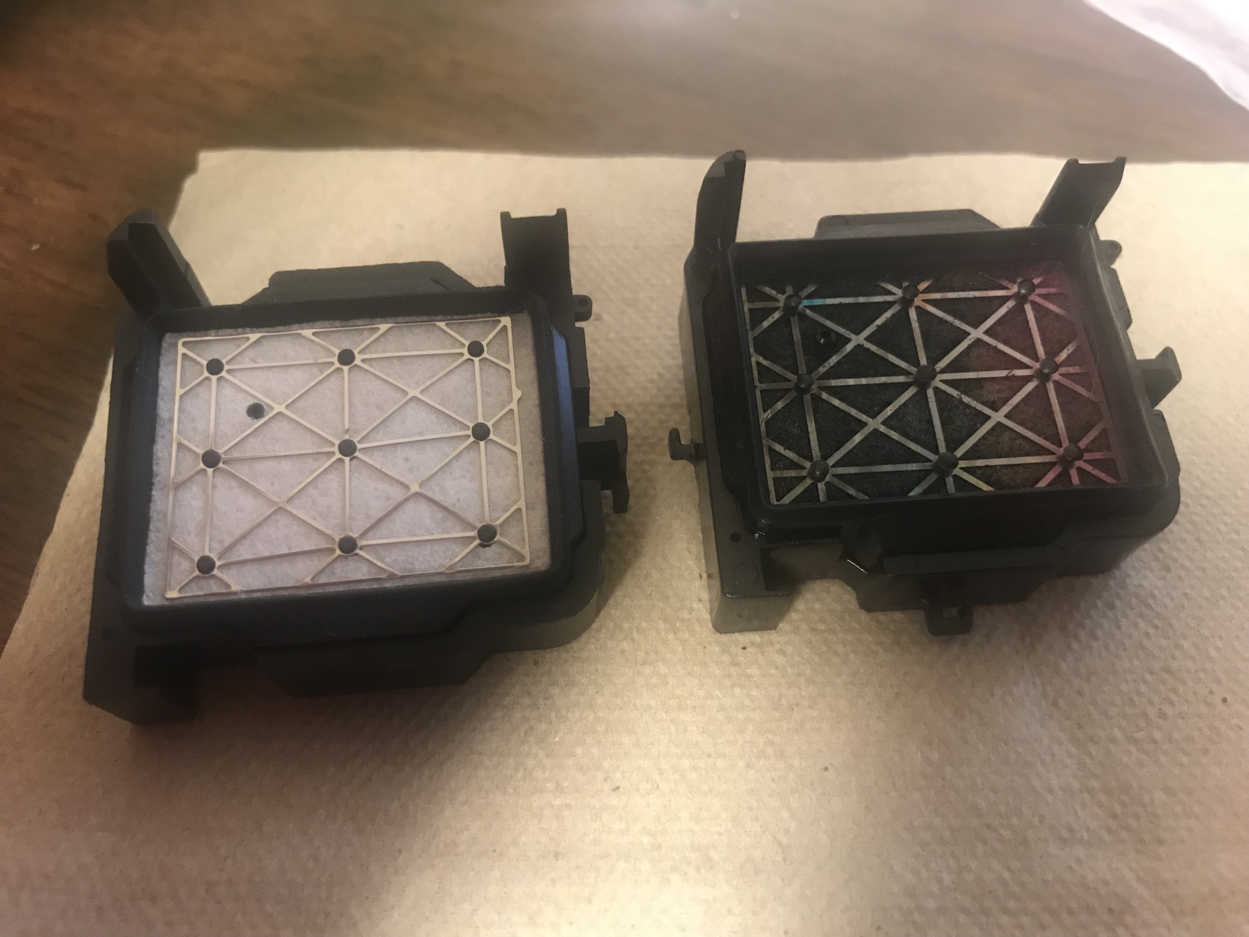

As many are aware, keeping your ink train - cap top, maintenance station and drain lines clean and in good shape is PARAMOUNT to good quality printing on ValueJet printers. Instead of swapping out entire maintenance stations at the cost of $600 +/-....I have gotten into the habit of just replacing the cap top. Normally, this seems to fix any issues I have - apparently the rubber seal wears down, or just wears out from solvent and normal use and no longer makes a good seal. (If you fire your machine up from sitting overnight and notice nozzles missing, this is a good place to start checking) So a few weeks ago I started noticing nozzle dropout in both magenta and black channels - these are often first to show if you're not getting a good seal around the head with the cap top. So I replaced the cap top with one of 2 that I had on the shelf. NOTE - both cap tops were aftermarket (non-OEM) that I had ordered from digiprint or somewhere. Even after replacing the captop I still had problems getting good nozzle checks and again, magenta and black were the most affected... I even went so far to throw the 2nd cap top in the machine just to be sure there wasn't a defect with the 1st...the problem still persisted.

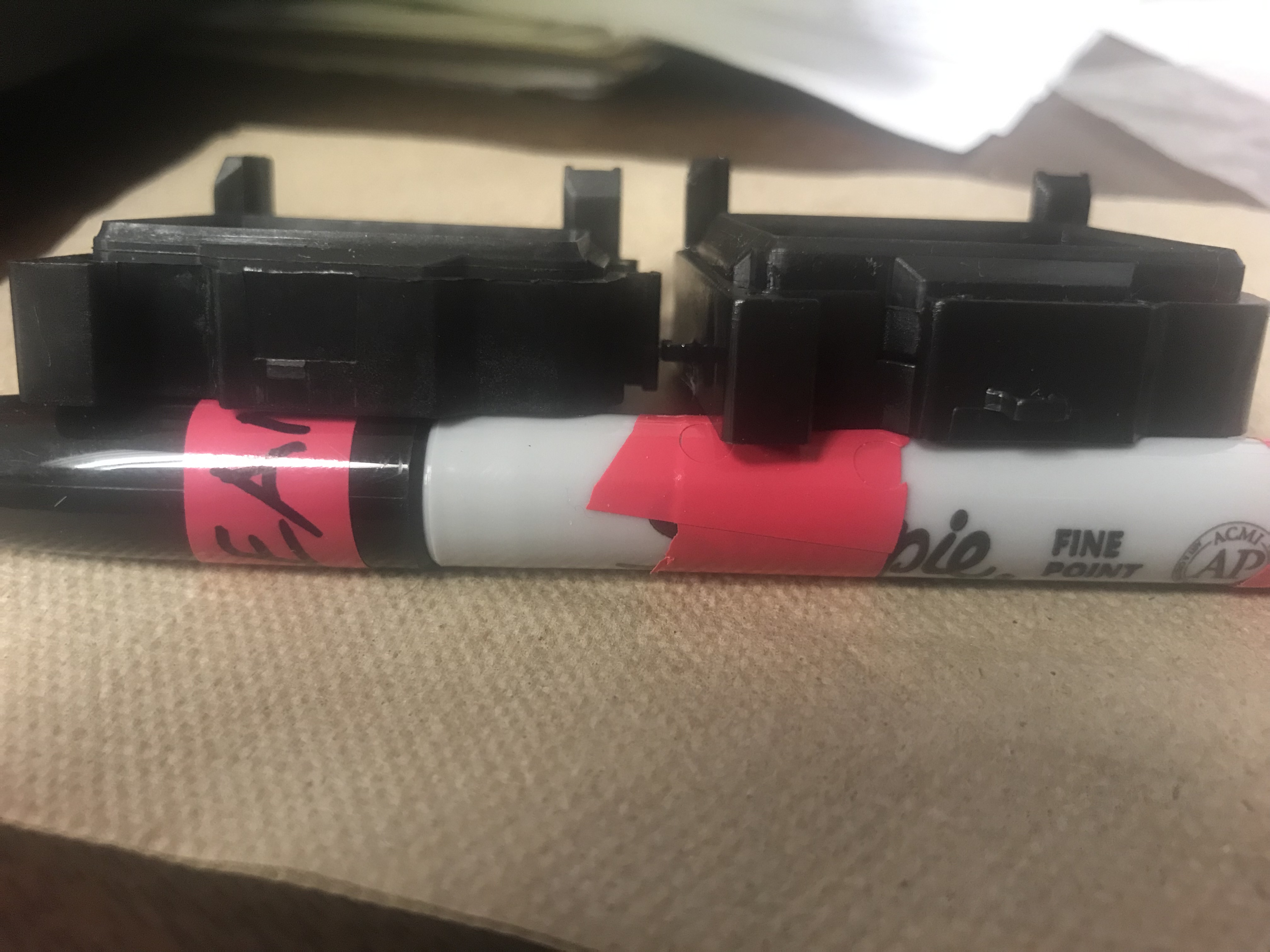

CONCLUSION: there is a noticeable difference in the performance of aftermarket vs. OEM cap tops. The pic below shows OEM on the left and aftermarket on the right. Just from "feel" alone, the OEM rubber seal is softer and more pliable - the aftermarket is hard and less flexible. Also, I noticed the rubber seal on the aftermarket is slightly taller...so spec is a little off as well. Price is about double or triple of the aftermarket, but honestly, if it don't work - why buy it?

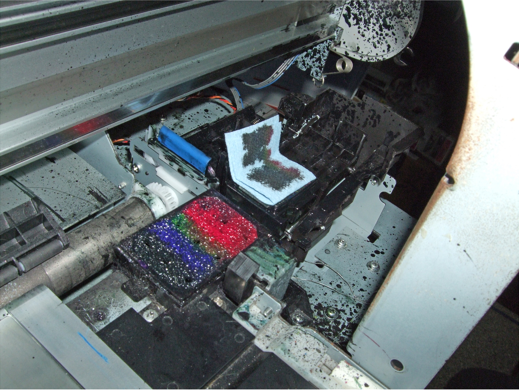

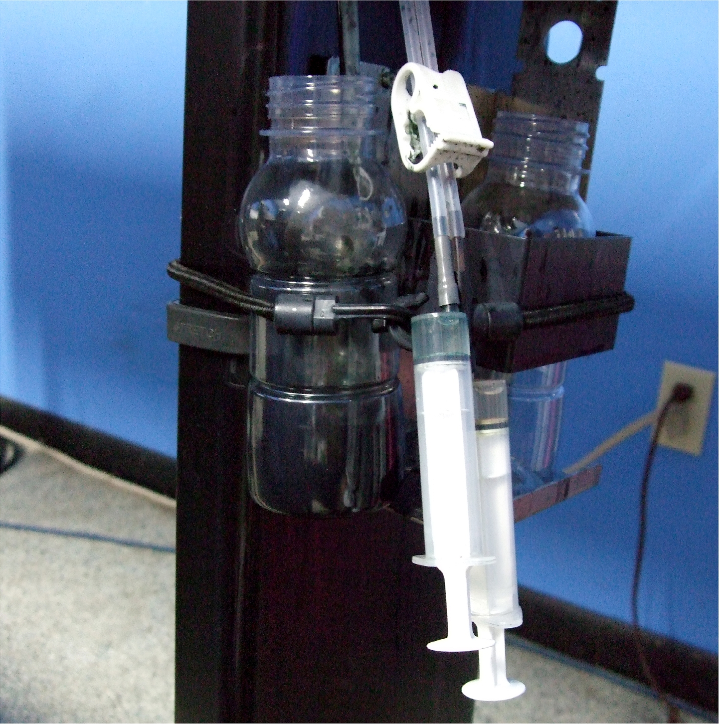

Everything that FatCat said is spot on. I have a six-year-old 1204 and the main problem I have had with it is the pump tubing. Four months after I bought it, the pump tubes were completely clogged. It was under warranty, so they sent me a new MS. By then I was tired of the waste ink tray. So, I replaced it with a waste ink bottle. Of course, I had to also put in a drain bottle for the spit box. The pump tubing going to the waste bottle was longer, which was OK because I like to see the ink in the tubes going into the bottle when I do a cleaning. But, the longer tubes held more residual waste ink and made it easier for them to clog up because of air getting in the tubes. So, I started using 2 syringes, each with about 2ml of cleaning fluid, and pushing the fluid from the bottom of the pump tubing up into the cap top and them pinching off the tubes over night. If I push too much fluid into the cap top, I just sop it up with a piece of Scott towel. Fluid left standing in the cap top can lead to cross contamination. The first time I started doing this every day, the MS and cap top lasted about 2 years. And I haven't had a pump tube get stopped up in the last 5 years. I also use a swab and cleaning fluid to moisten the rubber on the cap top after I turn the printer off for the day.
As for replacing the cap top, it's not that easy for me, but it is doable. You need to push down on the right side of the cap top until it slips off the rail-like track that holds it in place. That's always worked for me.
