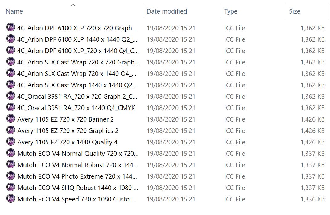

Have you managed to get any proper media profiles for this machine.
I am having a headache and issues with some of the ones I have tried.
Very limited on profiles for this machine.
SC
PanFastic
SC
I use FlexiPRINT SE Mutoh Edition. I have plenty profiles. I cannot fix the media cockling. Today I switched off all heaters. I managed to print 2 meter print without the head hitting the vinyl pocket.
PanFastic
Are they specific profiles or ICC ones?
Thanks
SC3
I don't know the answer of that question as I don't understand it / I'm not knowledgeable enough on these maters. I just made you a screenshot of what I have, it says ICC, so I'm guessing the answer is ICC.

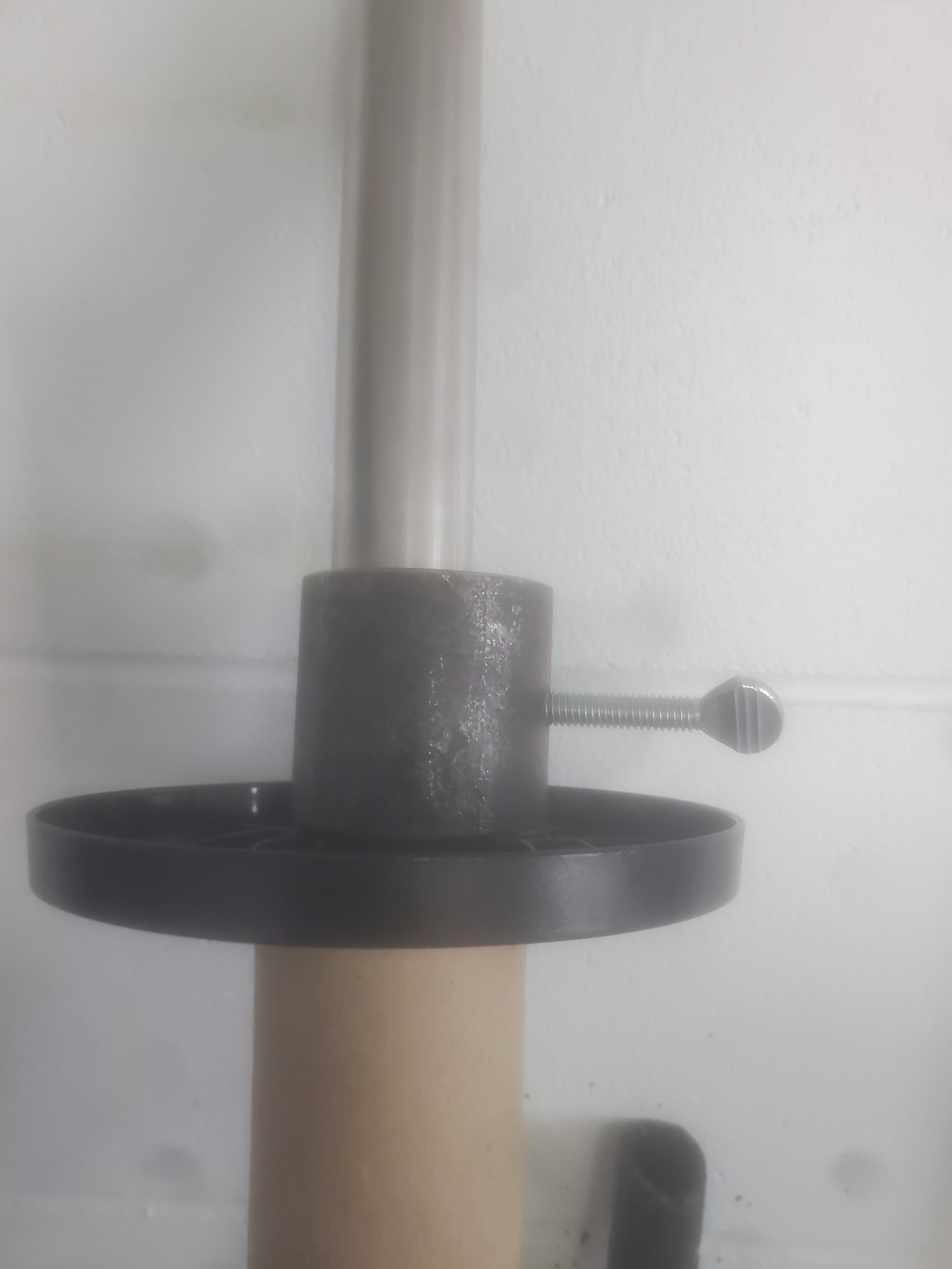

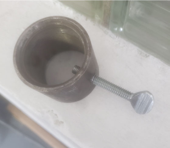

We have had the same issue with the flanges slipping out of the media roll after a while (use to work fine but after time the flanges began to ware out and not hold as tight anymore). At first we were tapping around the end to avoid this (did not work the best and a hassle). We later took about a 2"metal pipe with a diameter a little bigger than the bar holding the media roll, had a hole drilled in the side of it for a thumb screw and slide it on the bar and tighten the screw, see pictures attached. This works great and not had issues with it slipping off since.

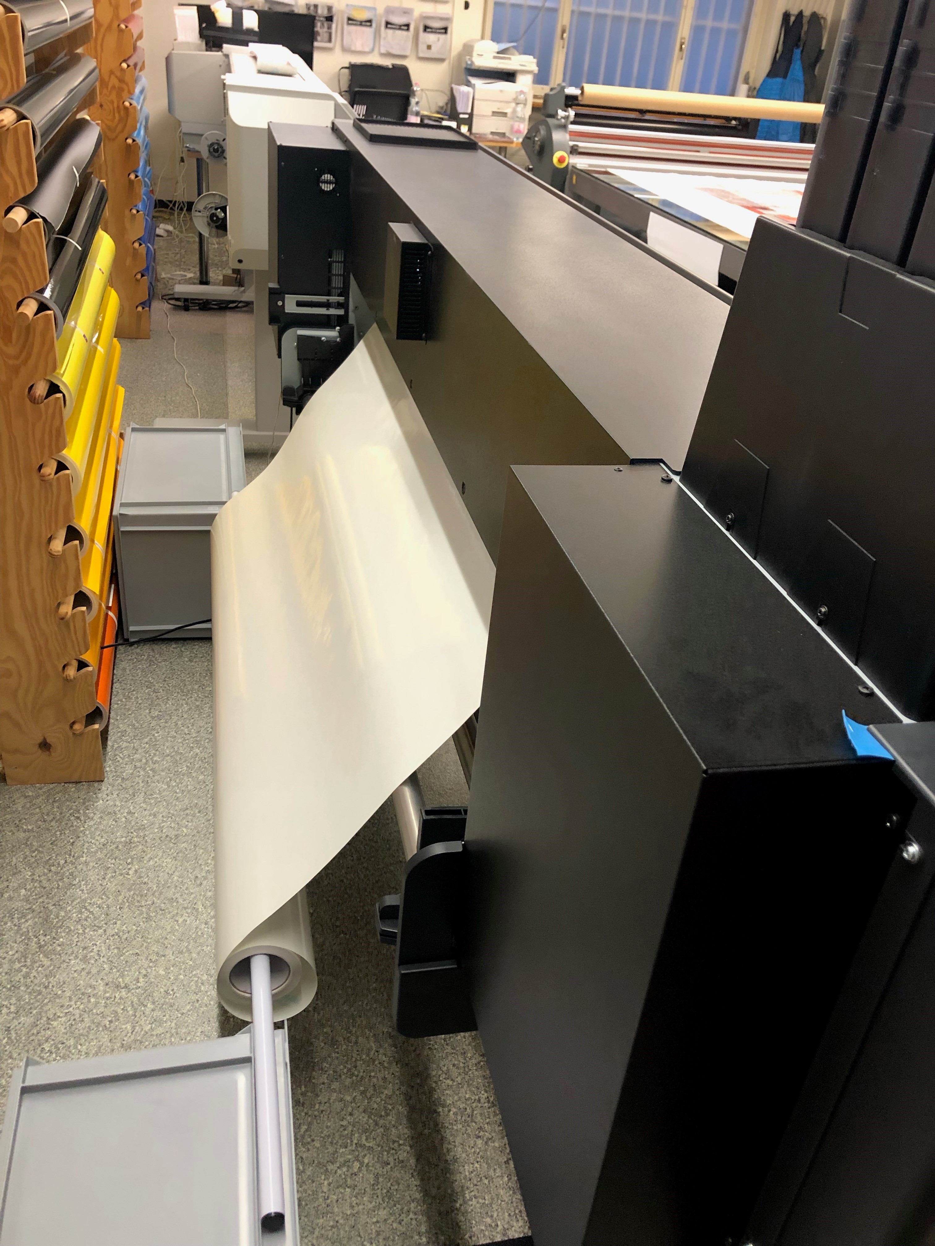

The photo bellow shows that the problem has nothing to do with the temperature in the room. Its their shitty product.
One night I had an urgent job. I was getting lots of head strikes. I did this solution as on the photo bellow and guess what, no media cockling.
They take up system / feed system is under-engineered. Mutoh support is just the same as the feed system, shitty.
