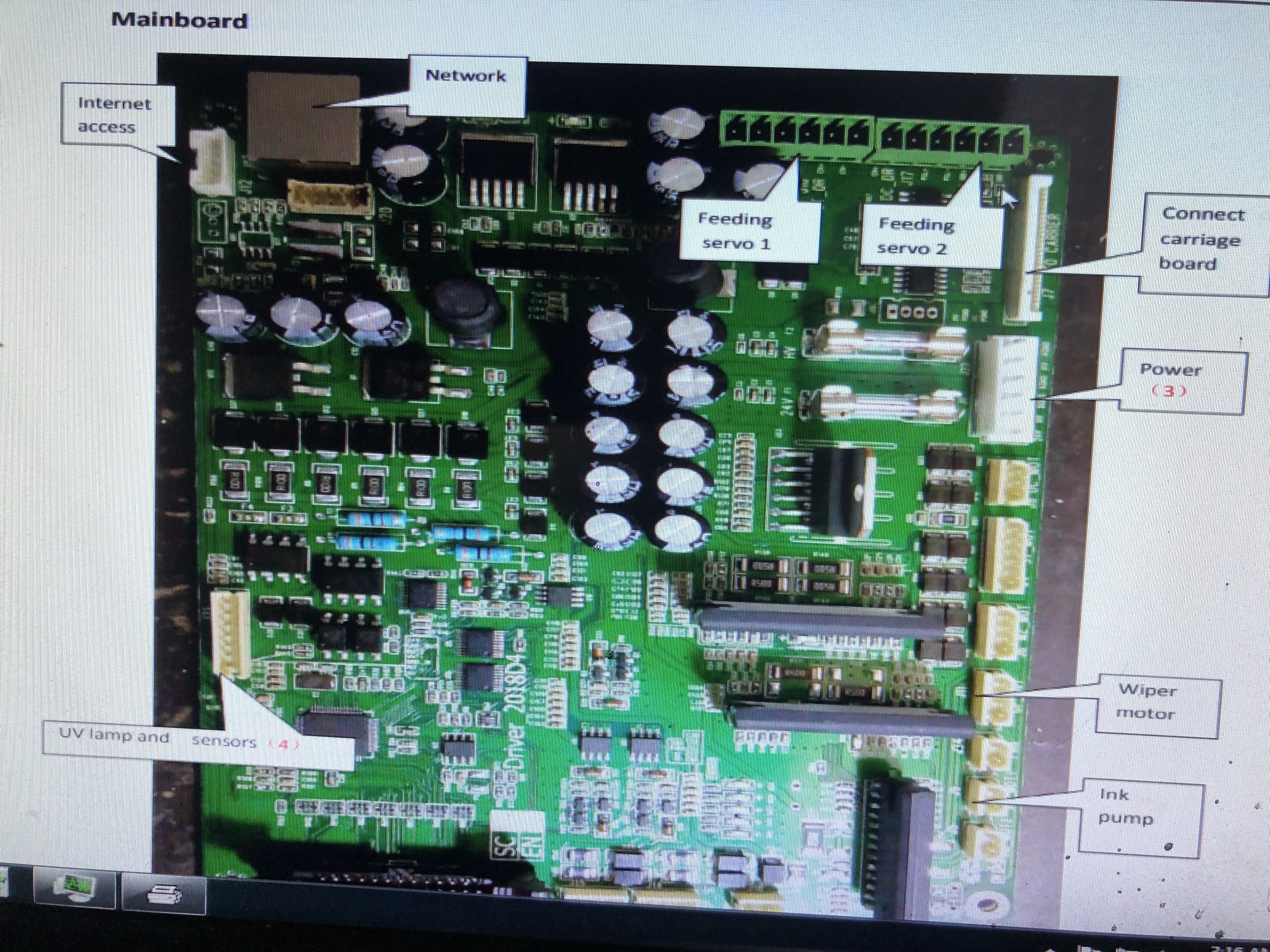

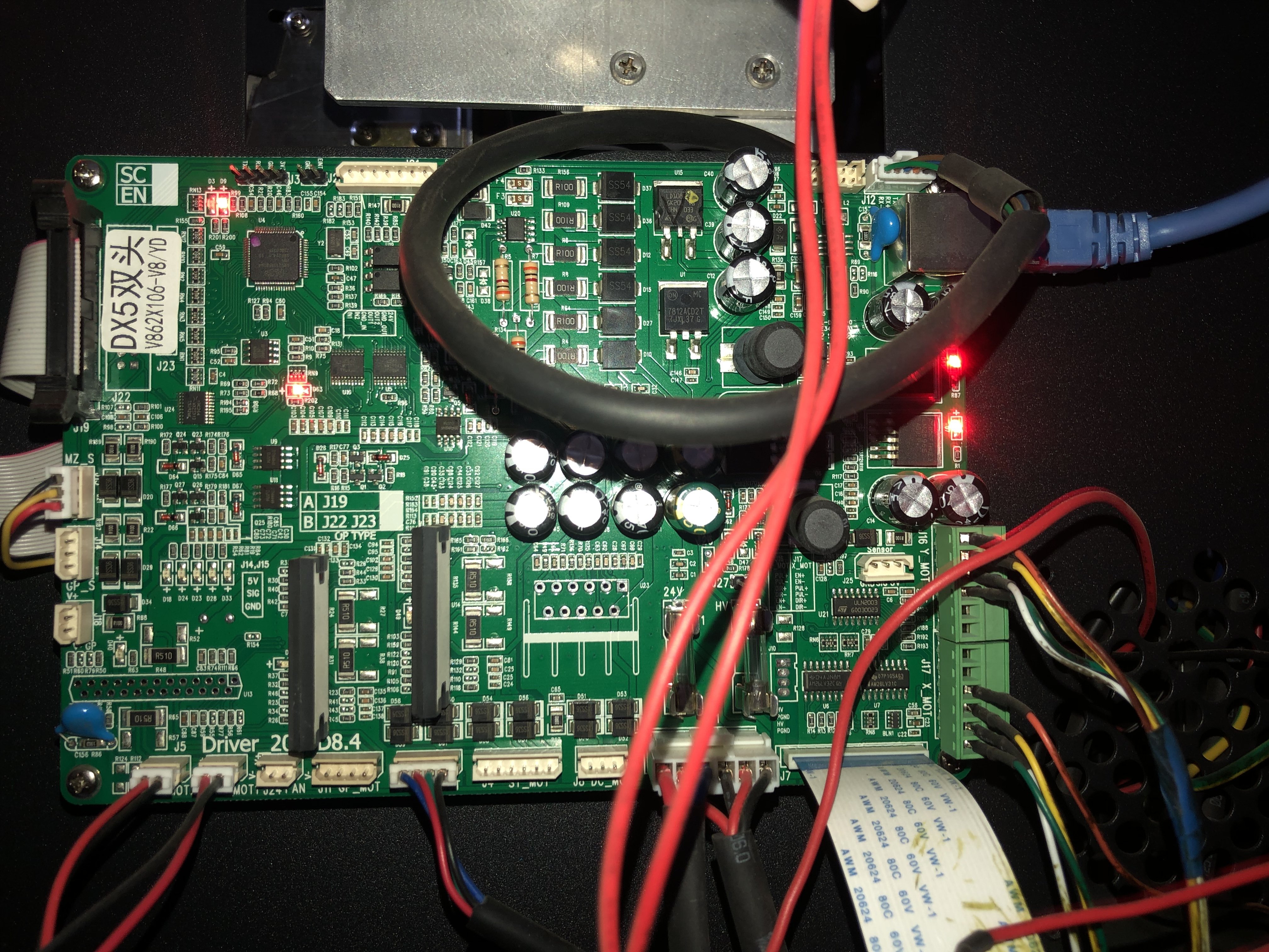

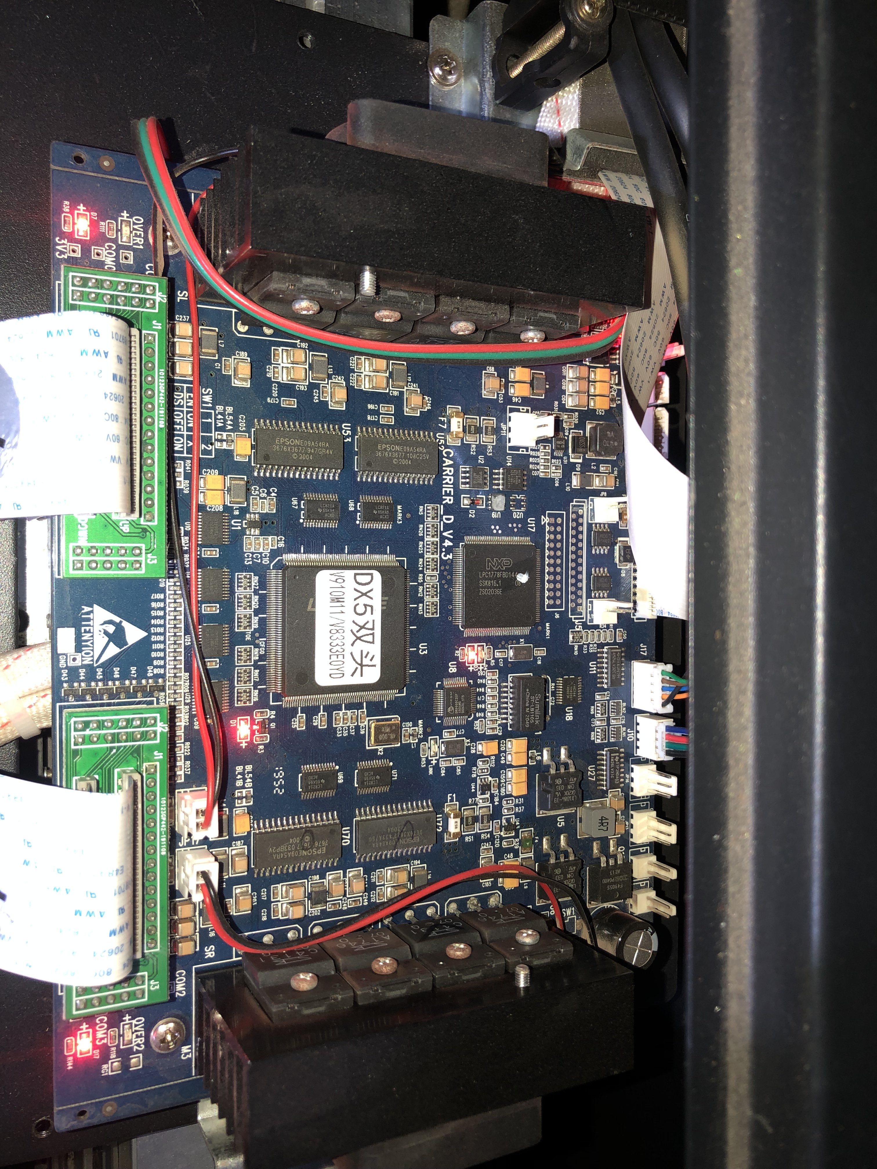

Need Help My 3200 printer recieves and prints very slowly, here are my details
sethkyejo
Tonyrich Arts
So its a Yingye 3200 printer and i know its chinese with all the issues these machines have but. It has two dx5 heads with a dx5 double head (V910M11/V8333E0YD) mother board on top of it(photo attached) and on the side where the connection with the computer is initiated is the dx5 double head v862X106-V8/YD (Also photo attached) motherboard. This is where the ethernet port is located.
Now the way that it prints its by direct ports from the maintop printer manager which is responsible for sending jobs directly from maintop to those boards mentioned above.
The problem starts when recieving and printing, it goes one side and rests then finishes one move which takes alot of time, and keeps saying not responding on the maintop software.
Things i have noticed is that the ethernet port lights with orange and red, while it should be green and orange, even on othere printers here the light is green and orange, now orange and red indicates that the speed of the ethernet is slow, even after trying other computers, telling me that its not the computer its the printer so how do I exactly fix this. It wastes alot of time.
The other photo is for the only software for seting up the boards, thats the only one they gave us.
Please help

netsol
NORMALLY,
red flashing indicates network collisions.
you could try downloading something like wireshark and see if you can see any sort of unusual event that happens while the led flashes red. It is possible you may need to reconfigure and isolate the printer in a vlan but i tend to think this is just a case of poorly implimented firmware.
The problem with chinese devices like this is no one is killing themselves correcting what they consider to e "minor" issues
How are you connected?
Gigabit switch?
Is it a smart switch?
If the device is a cheap one, try another.
It might be worth going into your router and exploring QOS settings and list the pc and printer, like you would with cisco or other VOIP phones.
It occurs to me your problem may just be an absurdly long time out after collision, before the device resends the lost packet
I suppose as a test you could simply connect the pc and printer directly through a cheap gigabit switch. I don't like using a direct ethernet connection (1 cable) from pc to printer in these cases, it introduces more problems than it cures. If you try this, the indicator would be no more red flashing, not necessarily an increase in speed. We would need to explore machine settings, service menu access, etc.
It may be a waste of time but have you tried emailing tech support for the manufacturer?
One last question, does this happen all the time? Only with complex jobs.?
Only when printing white?
Have you tried a "simple" test job, to see if there are still collisions?
I will be watching this thread if you reply

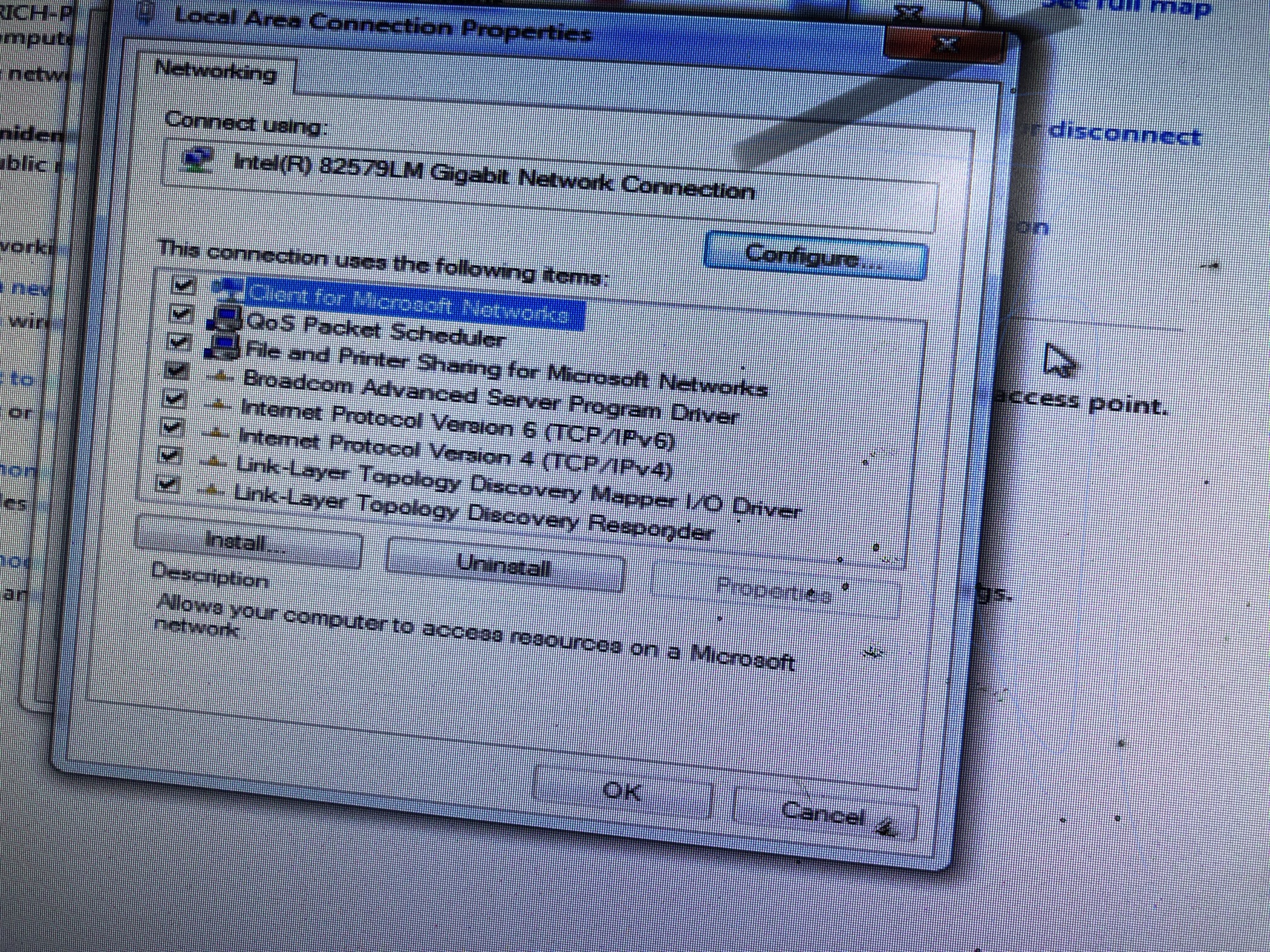

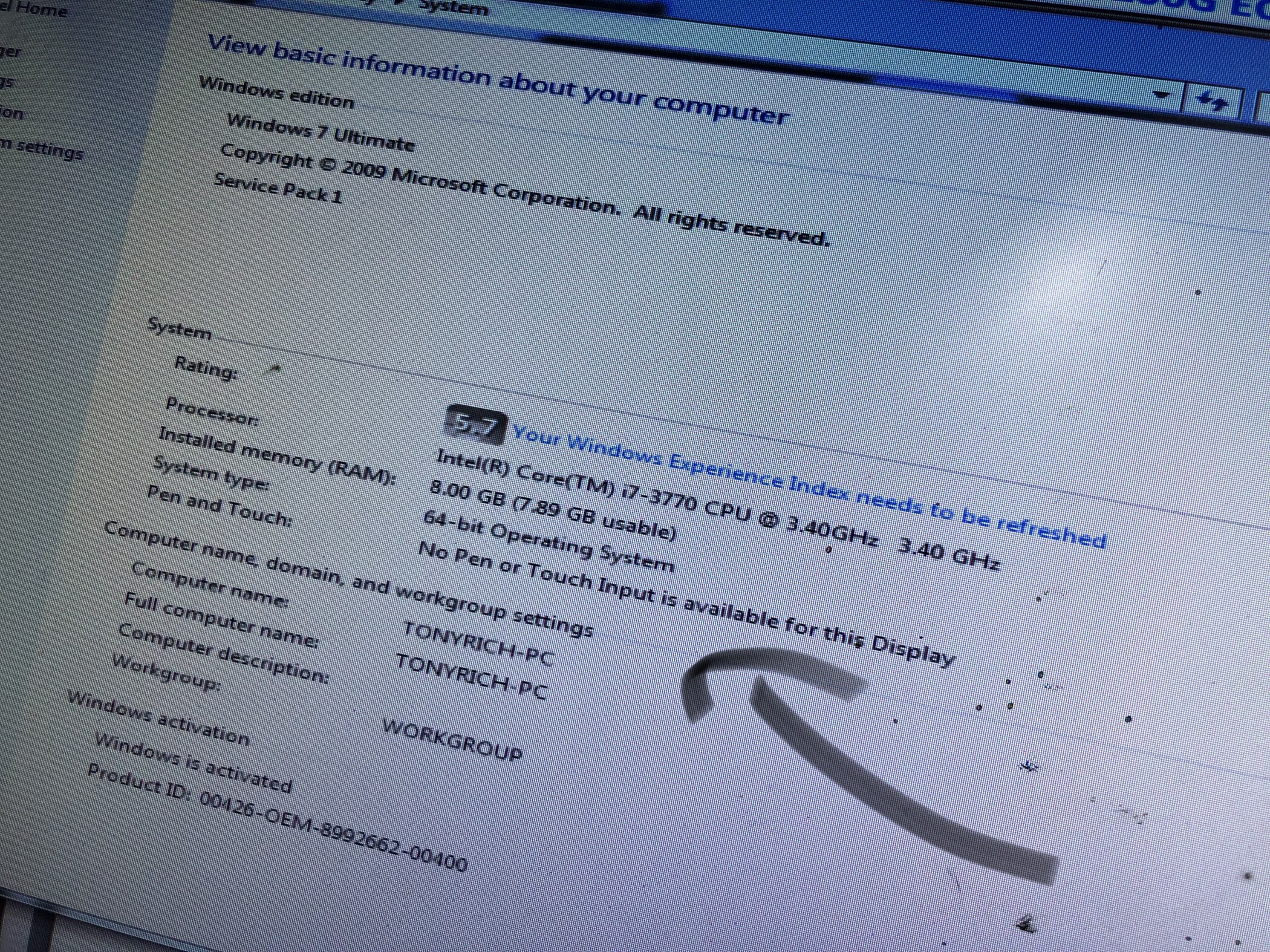

Well thanks,
First, i did contact them they weren’t sure why so they sent out this connection cable that runs from the main board all the way to the head board up there, this ddnt change a thing, in the picture they labeled it internet access.
Second well its a direct connection from a computer to a printer thats how I always knew it is supposed to be, and i knew this because i have a 1.8m printer of the same manufacture and it uses a direct connection too, and it never lagged,
Also, Yes it happens all the time, it is even worse when when the work is huge like 1200x300 cm this takes forever, but even a 100cm x 100cm also lags but atleast after two runs meaning left to right twice then it stops before continuing.
I also attached the network card photo and computer specs to see if there is anything fueling that.
And about the firmware i kinda agree they poorly designed these boards, i dont know how but with a bit of experience i have on printers this could be it.
netsol
Can you order amazon?
It would be worth plugging in a small gigabit switch between the pc and printer
All these network devices "autonegotiate" deciding if a regular canle or crossover cable is needed.
Until a few years ago microsoft told us direct connection, without a switch was not supported cofiguration.
Autoegotiation does not guarantee a device functios properly i either mode.
Last month we had serious issues with a $30,000 cisco router that would not link without a crossover cable. So this is not outside the realm of possibility.
One more question, what software/rip are you using?
Perhaps a bad header or identification bit comng before the data
It might be woth trying a 7 day demo of flexisign to see if the improperly implimented driver is causing all those red flashes. T

netsol
ARE YOU SURE, the network is linked at gigabit speed?
This actually could just be a problem with your lan interface on the pc
I still suggest you get a 5 port gigabit switch and 2 Cat 6 cables (less than $30. From amazon in USA
This could save us hours of poking around
Send me the details of your pc
Manufacturer, model
Operating system
Go to device manager and see what the ethernet is identified as
If wrong driver is loaded, it probably defaults to 100mb
If corrrect driver is loaded, we can probably force to gigabit speed
I have been a network consultant since the early 1990's, we will get this resolved, one way or the other
Please do not remove and reload anymore. This never helps and can introduce additional problems

netsol
can you check link status? i am pretty sure it will show 100 mb speed link
this could be because the interface doesn't support a gigabit speed in the absence of a network switch (the connection IS different)
it could also be the network descriptor sent out by your printer is not recognized by the O/S so we default to slower speed
there is also a slim chance that we only do gigabit on a "properly configured" network with dhcp and dns services running
when you open a command prompt <start, run, cmd, enter then type ipconfig <enter> do you show just an ip address (what is it? ) and a subnet
ie: 192.168.1.100 , 255.255.255.0 or do you show a (fictitious) gateway ie: 192.168.1.1 ? there are a million rules & not a lot of standardization (and not a lot of standardization FOLLOWED)
here is an article from microsoft on forcing your connection to gigabit speed:
give it a try
i just checked, i can not add an address in tanzania to my amazon account (i have done this for several european countries, i figured it was worth a try)
keeping my fingers crossed that this will resolve your issue
