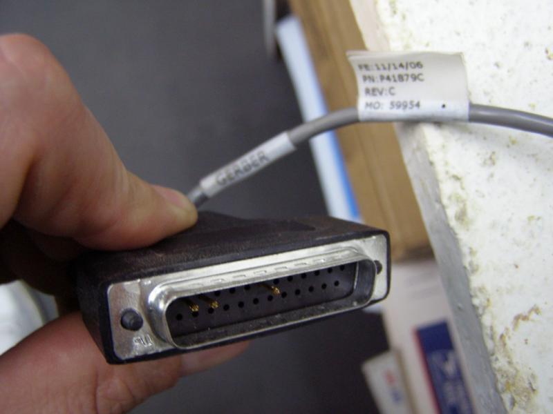

I am trying to use the plotter with a Gerber cable that I had purchased from Hyatts for my GS15 (see attached). The Envision users manual mentions a "25 pin" serial interface cable...the one I have appears to have only 3 pins(?) I guess this would be my problem??

OOps- forgot the pic
I didn't see an option to upload a pic when editing my previous post (?)
my gs15 has a 25 pin cable, and so does my enV375...don't know where you got a 3 pin for your gs15....
I am %99 sure i got it from Hyatts 2yrs ago. I am %100 sure that I use it to run my GS15/GA6.2, as I just did today. :D
