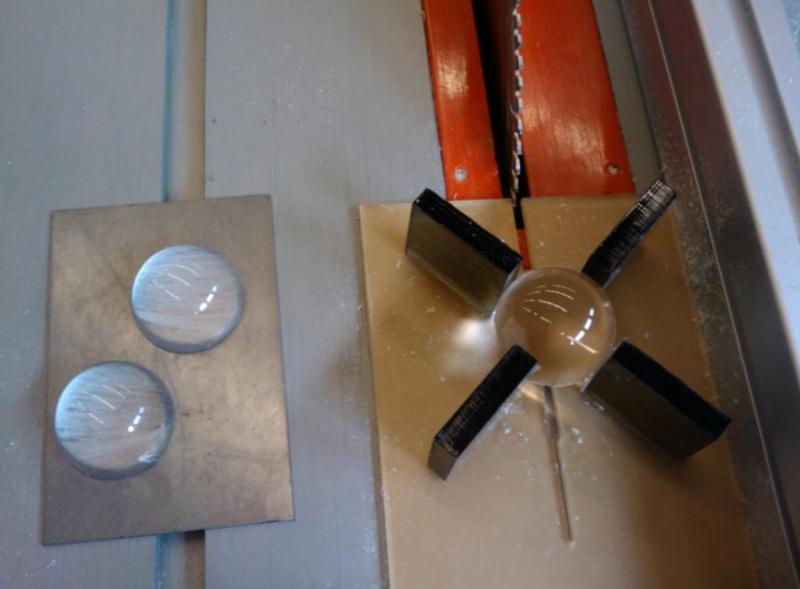

I have 2" acrylic spheres that I need to cut in 2 halves to convert them in cabochons(will become dots on I's). I bought balls because they were 1/4 the price of cabochons, plus I get 2.... only thing is I have to cut them nicely.
I have a sawbench with a decent blade, but no bandsaw. I have a co2 laser I could use for making a jig too....

Ok I found a way!
Anyone interested to know, here is the little jig I made to hold the ball. I put some double-sided tape on two of the tabs so the ball wouldn't start spinning. The rest was easy. Perfectly sliced in the center...
