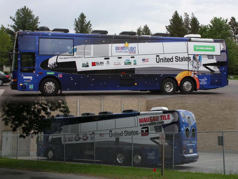

We do sponsor updates on a bus for an educational program in our area, they send us the files they want, we print-cut them and when the bus is free for a day we peel off the old and put on the new. I don't know what material the full wrap is, we didn't install that, but if you take your time, use a little heat, not so much where you're going to release the bottom layer, the old ones can be removed without damaging the base wrap. We've been doing updates to this once or twice a year since 2012 and haven't done any major damage yet.
