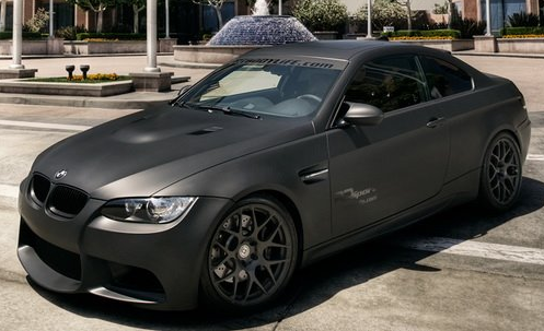

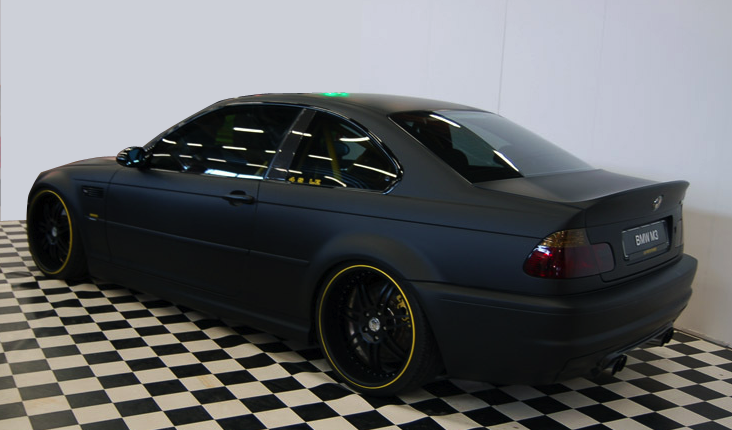

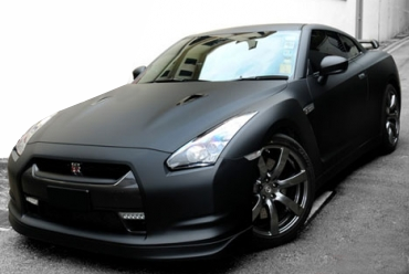

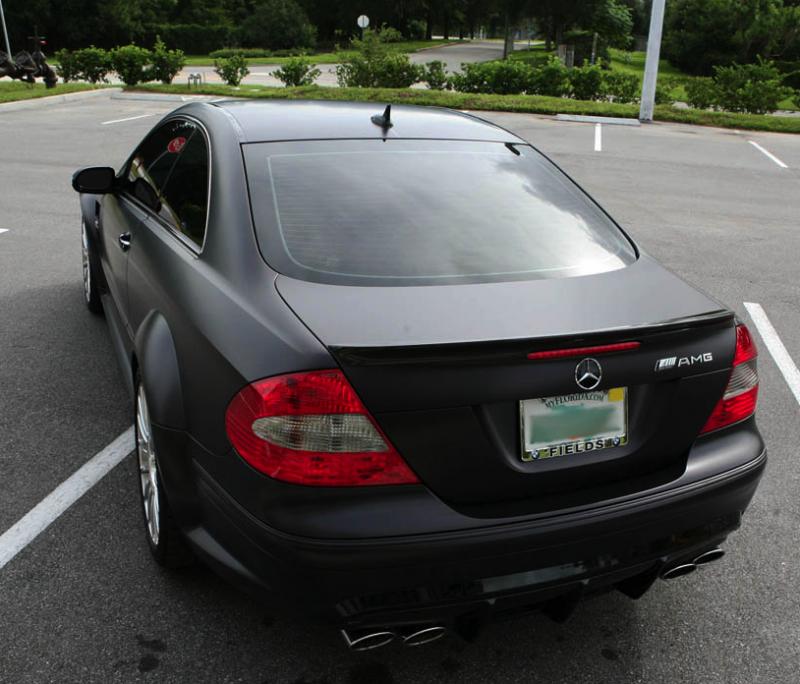

After looking at photos of flat black cars, last night with my son, we decided hands-down... we're going with flat black. It's just to cool to pass up.
Here's the look we're going for and the photos that sealed the deal.
