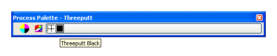

I don't think you can EDIT the palettes given to us from the factory. You could, however, just make your own:
PALman (Palette Manager)
Instructions from GSPComposer Help:
To create a new palette
1 Click Start > Programs > GSP OMEGA > PALman to open the Color Management dialog box.
2 Choose a color profile from the Gerber Imaging Device Profile drop-down list.
3 Click OK. A prompt appears on screen.
4 Click Yes to open the New Palettes Properties dialog box.
5 Choose either Vinyl or Process in the Palette type group box. You can only create a new vinyl or process palette.
6 Click OK to open the Palette Manager dialog box.
7 Use the scroll arrows next to the RGB or CMYK values to create a color. The color appears in the preview box.
8 Type the name of the new color in the Name text box.
9 Click Edit > Add.
10 To rearrange the order of colors in the palette, click a color and drag it to a new location in the list.
11 Continue with steps 4 through 7 until your palette is complete.

threeputt
Chris, that works! I'll have to laboriously convert all the colors I use to my favorites and name them, but I tried the idea out with the Rich Black I was trying to create and it worked GREAT!
So thank you very much.
Also, Bob, looked at your method also. It'd be a little more cumbersome, but you're right, it's be a work-around method. Thanks for taking the time with your detailed explanation.
