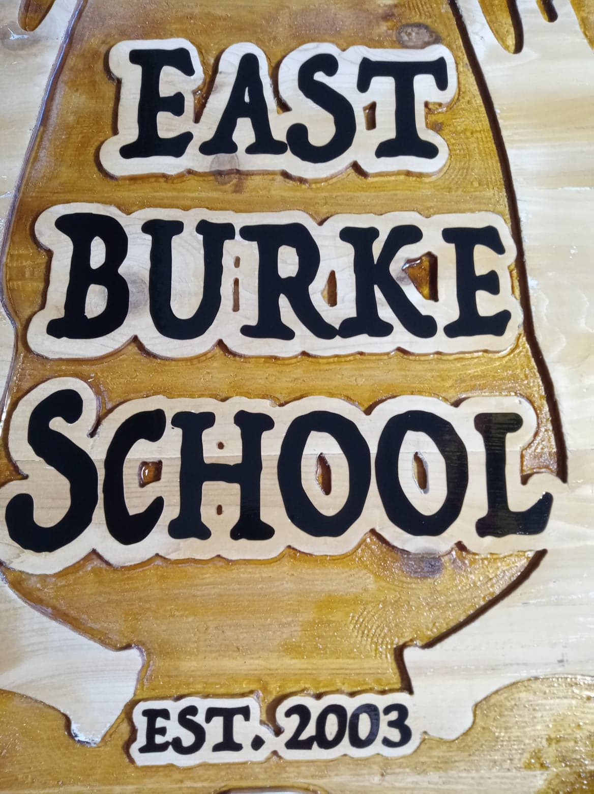

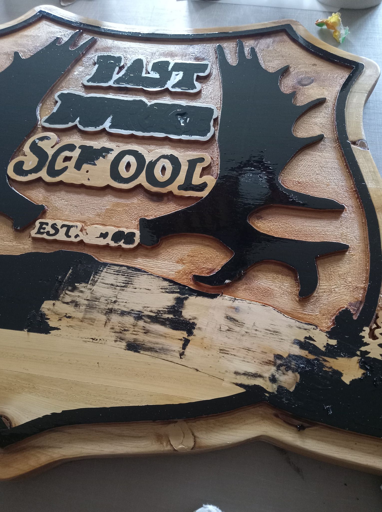

Hello everyone. I am new to this site so I hope no one is offended by me posting in a wrong area or something like that but I need to get this sign out. So this is my first full carve and paint sign. It is white cedar and the painted areas are all raised the rest of the sign will be natural. Because I was nervous about paint running down over the edges of the smaller letters I designed a natural wood border around the black letters and then used a mask Oramask 810 but it would not stick to barewood. I couldn't prime because all the primer I found were colored and I'm trying to maintain natural wood look. So I polyurethaned the whole sign 2 coats then used a mask and applied Zinser 123 Bullseye primer to the areas I was going to paint. I let it dry an hour and did a 2nd coat. I let this dry 4 hours then painted black with California paint. I let this dry overnight and this morning when I pulled the mask off the paint just peeled right off. So my questions are is there a clear primer that you guys use that would allow my mask to stick to it and how long do you guys let paint dry before removing mask. Is completely dry too long? Is my process wrong? Thank you for your help.

I see nobody answered this so I'll take a stab. I used to make those decorative wood signs using the same paint mask on pine wood. It rarely sticks completely to the wood. If I had an intricate design, I sprayed from a spray can a light coat of clear coat and let it dry good. No matter what, I found that I usually needed to use a small paint brush to clean up the edges and also a small razor knife to remove any bleeds. With the paint mask you need to use a foam brush and dab in several light coats or it will bleed. I ALWAYS pulled the stencil mask off right after painting or the paint dries to the stencil mask and pulls the paint off, just like what happened to you. Hope this helps a little bit. You could try using an actual intermediate vinyl, it will stick a little better but I never found it to seal the edges well enough to create a perfect painted stencil.

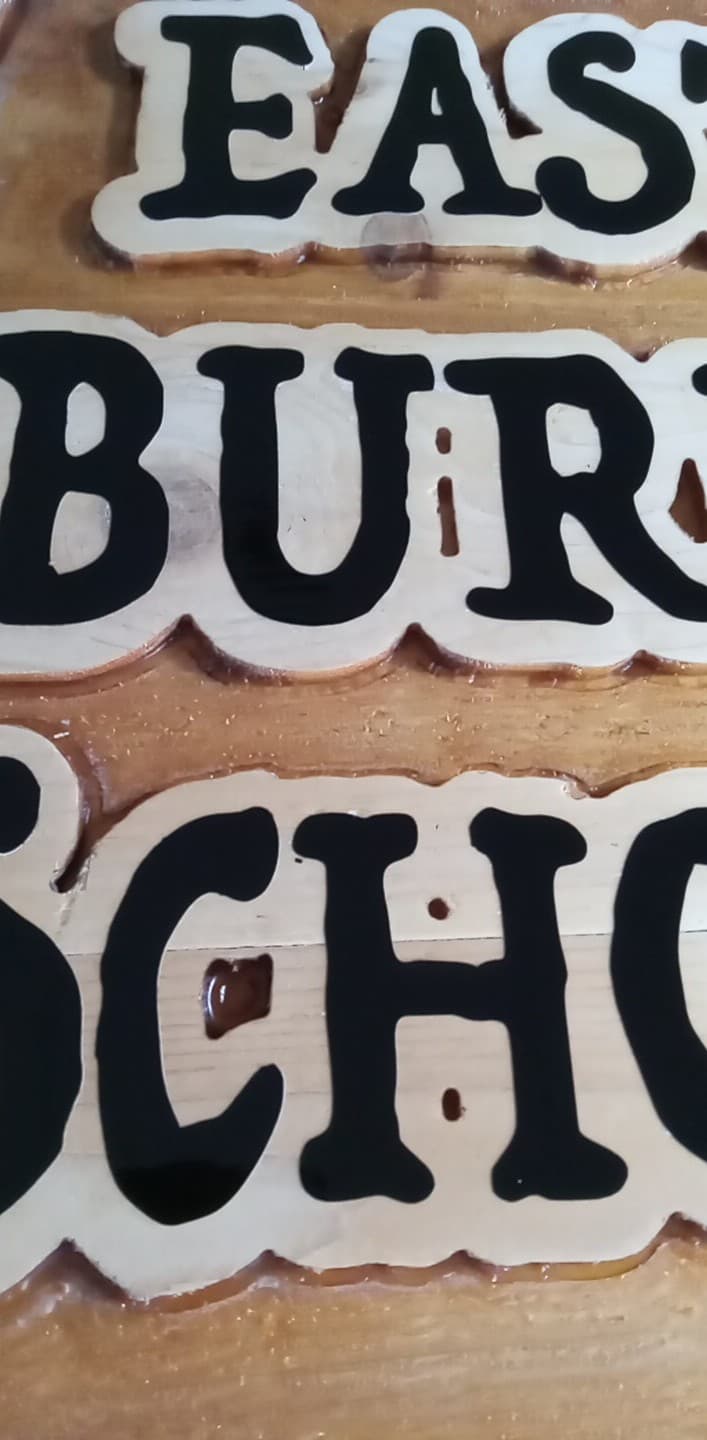

Thank you all for your advice and input. While I was waiting for some advice, I did sand it down to bare wood and I tried the app to see how it was sticking and it stuck great. I sanded to 120grit then cut my mask and stuck it in place. I did apply 2 coats of bullseye primer last night and it was dry this morning. When I read that you always peel wet I was concerned but also confused about how you would apply 2 coats of primer and let it dry before painting without moving the stencil. So I decided to put on a coat of black California Larcaloid Paint and peeled within 10 minutes. I was so happy with the results. Now the area around the lettering is going to be the only bare wood once I am done. I'm just going to put a final coat of poly over everything when it dries for 48hrs. Does anyone see any issues with that? And Gino I completely hear you on the heartwood. White Cedar is extremely knotty. I asked the customer before I started if they minded knots as long as they were solid and they said no. So I have 1 knot that is not solid and will not be painted over and it definitely doesn't make me happy.

You might be seeing bare wood vs the urethaned finish because there is no white. So I orginally did the whole thing in polyurethane then primed the areas I was going to paint but I let it dry on the mask and when I went to peel it, the black just pulled right off of the primer. Here is what I used for poly primer and paint. Poly I did 2 coats and let dry for a day and a half then masked and primed. Let primer dry for 1 hour 2 coats then over night for the 2nd coat then painted 1 coat of the black and let it dry overnight. Then when I pulled the mask it came right off the primer and I assumed I used wrong material. And yes the border was definitely to make up for my lack or experience, but it is not painted
