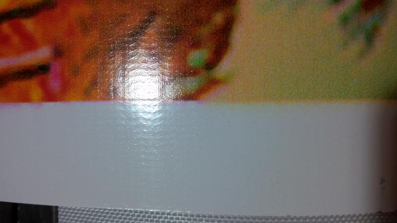

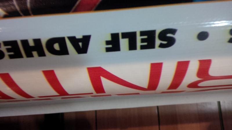

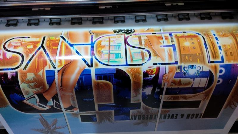

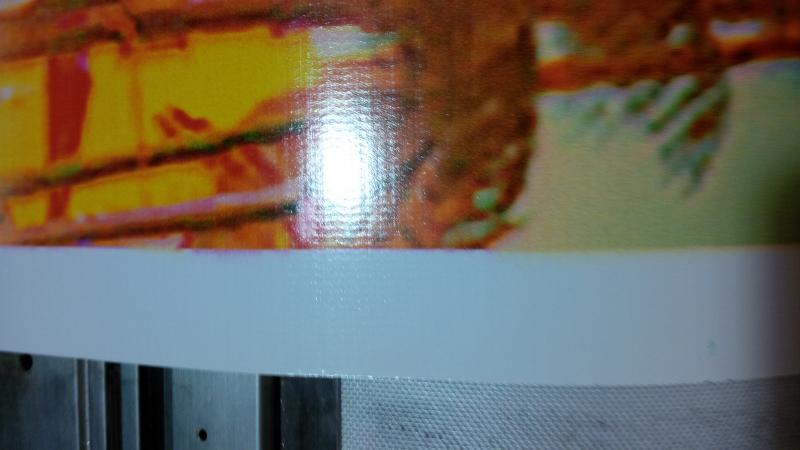

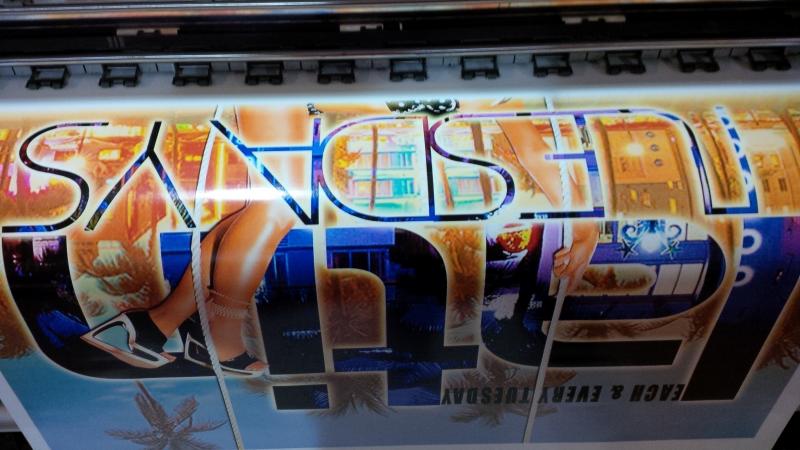

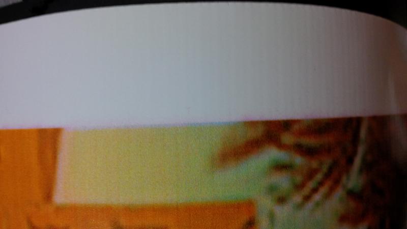

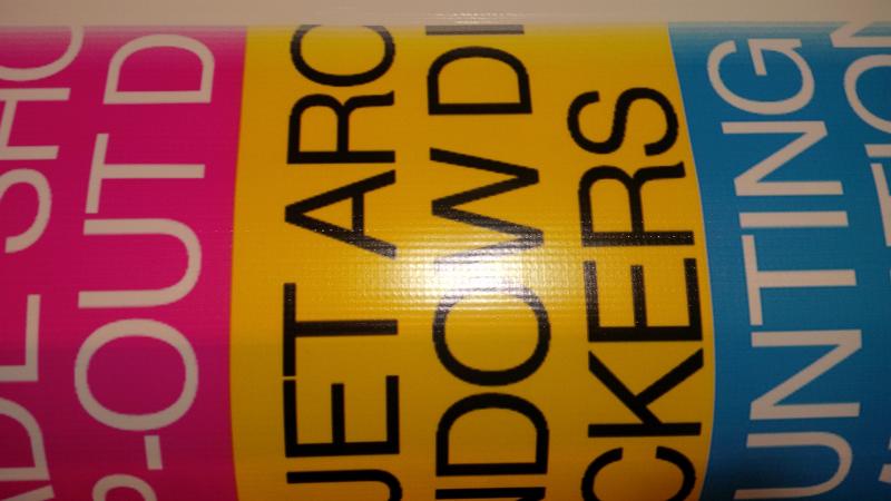

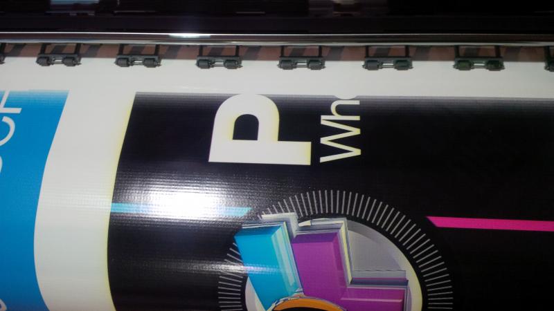

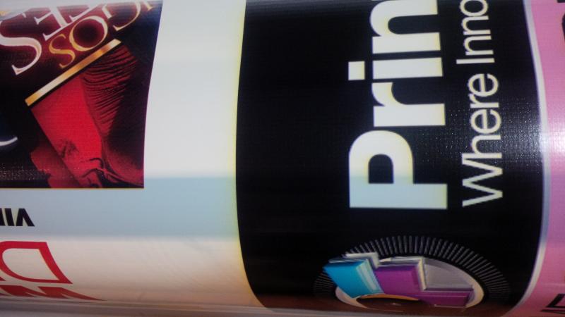

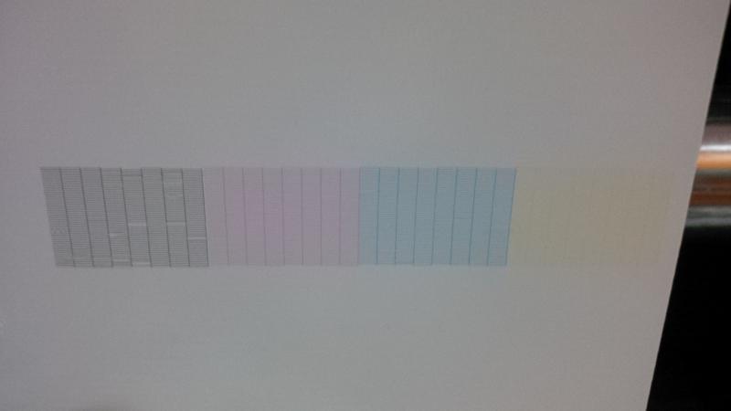

Hey guys anyone can show me how the fine alignment works dont mines is just printing lines no guide or plus or minus just the different color lines.
so far im getting some work done since the printer is printing better
its yellow overspray now not magenta with adhesive vinyl no banner material...
im guessing it could be static...
the last banner i printed it was all red and black and it didn't overspray only at certain points down the print....
so it would only overspray a piece not all

STILL HAVING OVERSPRAY PROBLEMS...
OILED UP BAR AND GOT RIDE OF OCCASIONAL Y CURRENT ERROR
HAVENT HAD ANY FIREWIRE ISSUES SINCE I FIXED SOME ELECTRICAL ISSUES WITH OUR OUTLETS.
JUST THIS OVERSPRAY... HAVE ORDERED SOME STATIC ELIMINATING TINSEL TO PUT ON THE MACHINE TO SEE IF IT HELPS WITH STATIC...
THIS IS A SOME IMAGES I BEEN PRINTING FOR THE SHOP.
STILL OVERSPRAY BUT ITS NOW ON YELLOW AND OCCASION SOME MAGENTA...
WHAT COULD IT BE MY NOZZLES ARE BETTER THAN PREVIOUS IMAGES

wow, can o' worms, maybe its just time to get a tech in there to at least diagnose your issues? you may be able to tackle the replacements on your own, but you're spinning circles here chasing a gremlin in the machine just trying to identify a series of issues that could really just be summarized as: you bought a lemon and now you need to spend some $$$ getting it to run properly. sucks, but it happens. It is still a great machine, and definitely worth putting the work into restoring.
at this point, i'd say flush the machine & try new ink cartridges (maybe the ink settled/seperated during storage/transplant? idk), and if that doesn't work then you're most likely going to need new printheads.
...even further, random y-current errors aren't good... could be a $750 motor replacement on the horizon as well.
wunder
longer ago same problem on SP260 and we have all normal things do and nothing was better...... ONLY 360dpi Mode no Overspray and Printheads firing fine aso.
So we have Change the Main-/Sliderboard from old SP75 and update all data/settings and Machine works very well with same Printhead configuration.......incredible :banghead:
After that we have rechange(original 260sp with same trouble) the Main-/Sliderboard and Update(downgrade) only the Firmware without parameterbackup and store all values manually ........and now we are in heaven..Machine works normal no more no less...... all modis 720*720 works with same PH
try it maybe it can be help you:popcorn: but one thing must say...i hate jv3-Machines :covereyes:
best regards
wunder

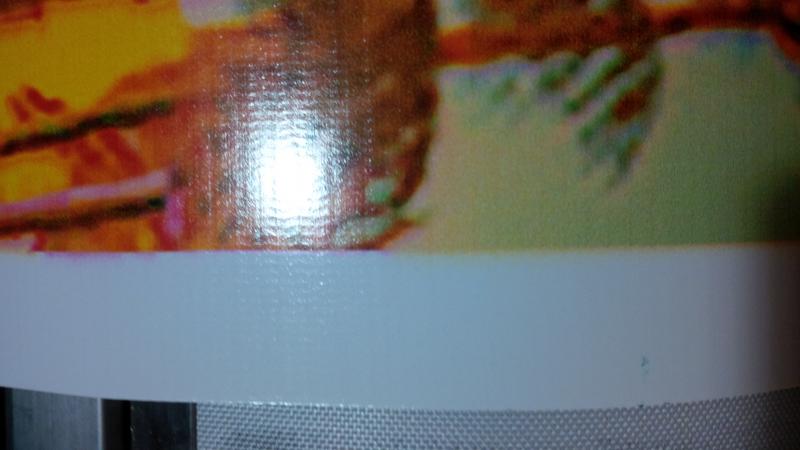

Update
After running and printing with overspray its now magically gone... no yellow no red no overspray whats so ever....
Ruling that maybe ink was causing this issue now that i ran trough that old ink it cleared up.
here and then i get a couple droplets of black ink im guessing the bottom of the heads are a little dirty will try to clean and see if that helps....
They are annoying the droplets
