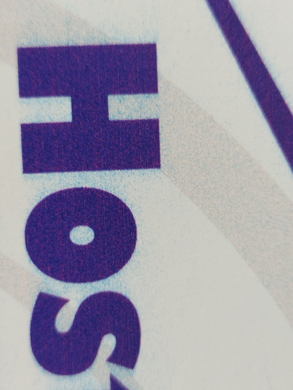

Hi, i have a problem and need help? Can anyone explain whay my xc540 print blurry ciyan color? I changed the dampers and test print is clear? This started happening to me after 15m of printing.

Can you post the nozzle test? Did you also do a nozzle test from the service menu? shows more details. Looks like ink spray from the cyan head.
miki rurki
Yup, Looks like ink spray too much from the cyan head.

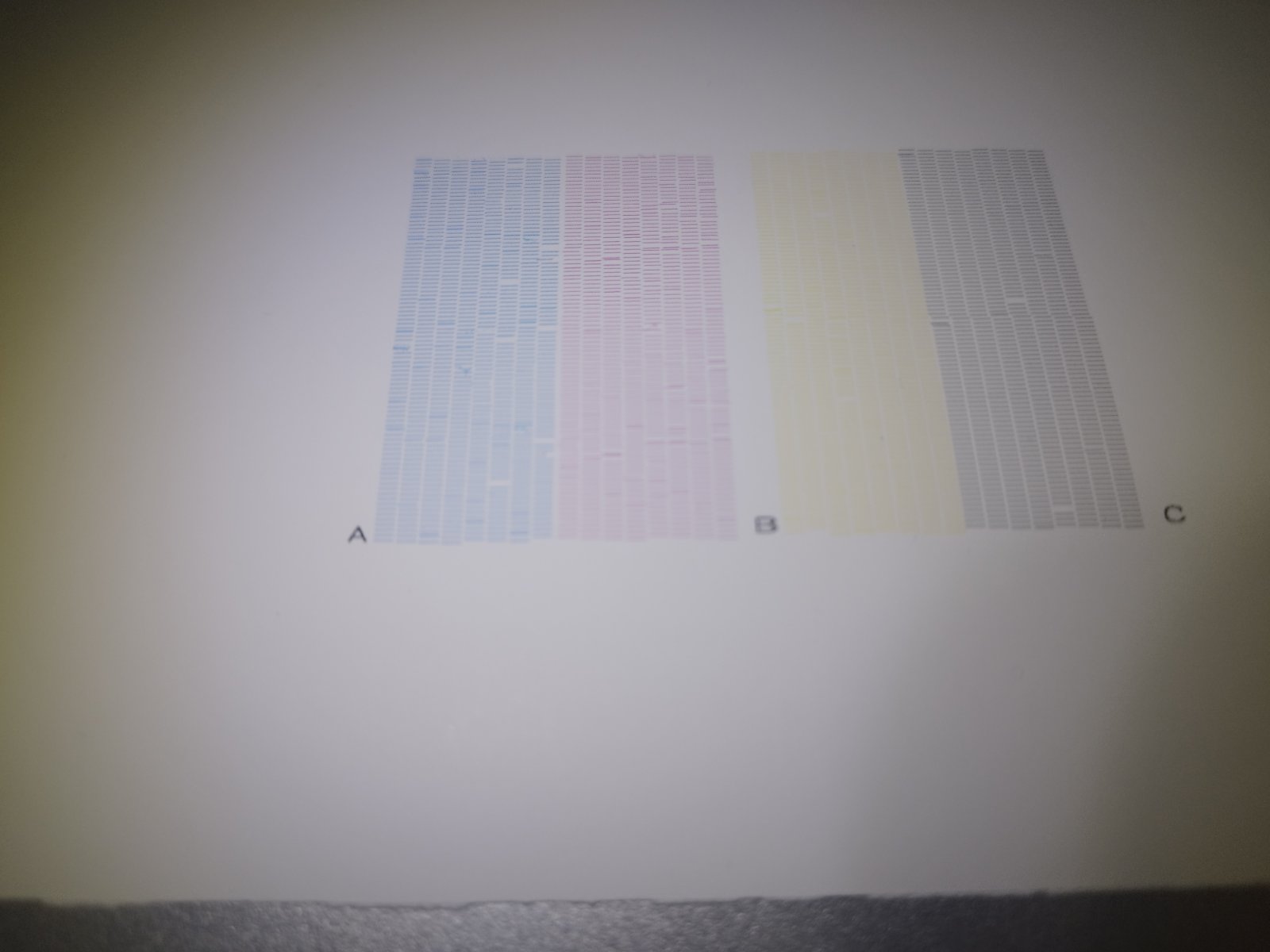

This is print test, I need to check service menu noozle test.

James Gallant
Graphic Designer
There is certainly some issues with the head, a good amount of deflection and there even appears to be head damage in the black, maybe from a head strike. There is a chance you'll need a new head.

Black is new head and not calibrated. I need turn screw left or right for a little. thansk for your answer
If the black is a new head, you have even bigger issues, as that head has deflection and missing nozzles. You must have had a bad head strike recently.
