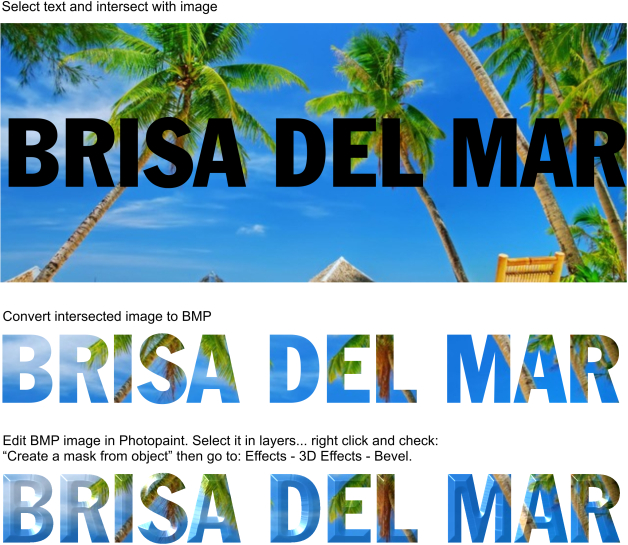

Well i finally figured out how to do this effect. I posed in the corel forums on their site and this is the response I got. Here is the how to if anyone is interested.
