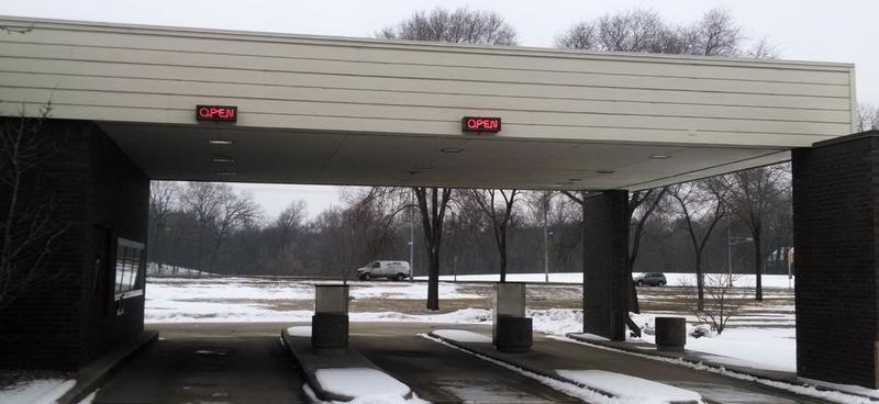

I have a bank that whats me to install a 3x5 or 4x6 rough size of a sign of some sort from the ceiling. The want it so that if someone was going to come steal it that it wont ruin the ceiling when the take the sign.
I was thinking coroplast with grommets, banner, polymetal?
What are your guy's ideas and ways to attach. I have not seen the ceiling in person. They are thinking of having a ad/sign above each drive thru.

Definitely not coroplast. The signs will need a bit of weight to them due to wind. Banners maybe... We would probably use Alupanel (ACP) and drill holes to hook them to a chain so they can be easily removed.
I'm wondering why they think anyone would steal the signs? I can't picture what they might say that would appeal to thieves...
You'd need to go check out the ceiling to make a proper call on how to attach them though. Depends on what kind of support is under those tiles and where.
You're gonna hafta re-think this. If you hang a sign in there, it will lower that head height to a degree, nothing will fit in there, but a scooter. I'd put the advertisement on the face of the wall coming in, make it as vandal proof as possible and look professional. Either make it of substantial aluminum composite or a heavy-duty banner. Anything else will look chintzy...... especially for a bank.

I have thought about the problem with height. If your going 4feet in height thats a lot. I will have to drive up there and measure and see what i am working with.
They want to swap them out monthly and they really dont care on cost.

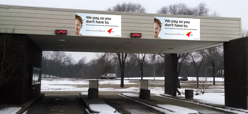

Ya get a set up for eye-hooks, install them and put a locking mechanism on it and with a little effort, they can change them out whenever they choose. You can do two like this or one long skinny one across the whole top.

Yep, what Gino showed. I'd use an extrusion like the bus ads use, one end removes, slide out to swap, and coro is the right thickness.

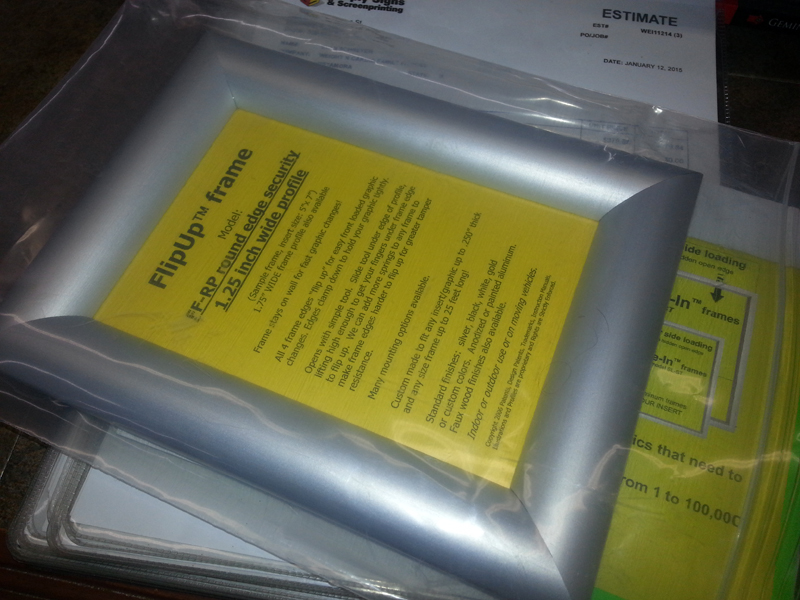

Use these, perhaps?
Alpina Manufacturing in Chicago manufactures these and they are not only a great product, but the wholesale prices on these things are ridiculously cheap so you can make a decent markup. You could do these with coroplast, PVC, banner material, or a host of other options.
