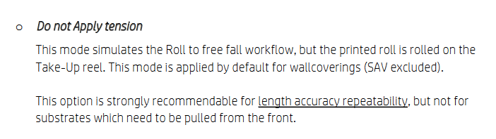

We already have the 800W almost a year now. Same story on every latex printer from 260, 360 uptill now differences in panel lengths wallpaper, from 0,3mm - 0,8 mm. We tried everything; Omas on of other profiles, new firmware. Result 0, still same issues. Is there anybody with THE SOLUTION for this problem?

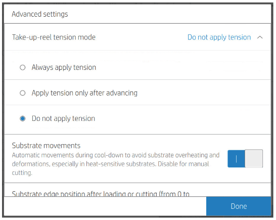

You have changed the take-up to work as "Do not apply tension"?
Anyway it sounds like you are inside spec. Lets say wallpaper is 3m long, it could be off 1.5mm and be in spec. Tiling length repeatability: +/-0.5mm/m
balstestrat
Problem Solver
We can't use this option because the wallpaper we use is to stiff
and will come to the curing system.
Then what have you set it to? I would select "Always apply tension" and aim for as low as possible tension value.
You must understand you have material limitations and the heat, it will never be 0.0 accuracy.
JohnvdH
It keeps it loose all the time but still collects on the roll.
For us it
We use: Allways tension, 6 Nm input tension, output tension 25 Nm, curing temperature 90 degrees. Wallpaper Desardi.
balstestrat
Problem Solver
Well you have a fuckton of output tension. Is that material really so rigid it needs that much?
Btw to keep the balance between input and output, you should have a little more input tension. I would put at least 15.
JohnvdH
Well you have a ****ton of output tension. Is that material really so rigid it needs that much?
thanks! we'll try these options.
