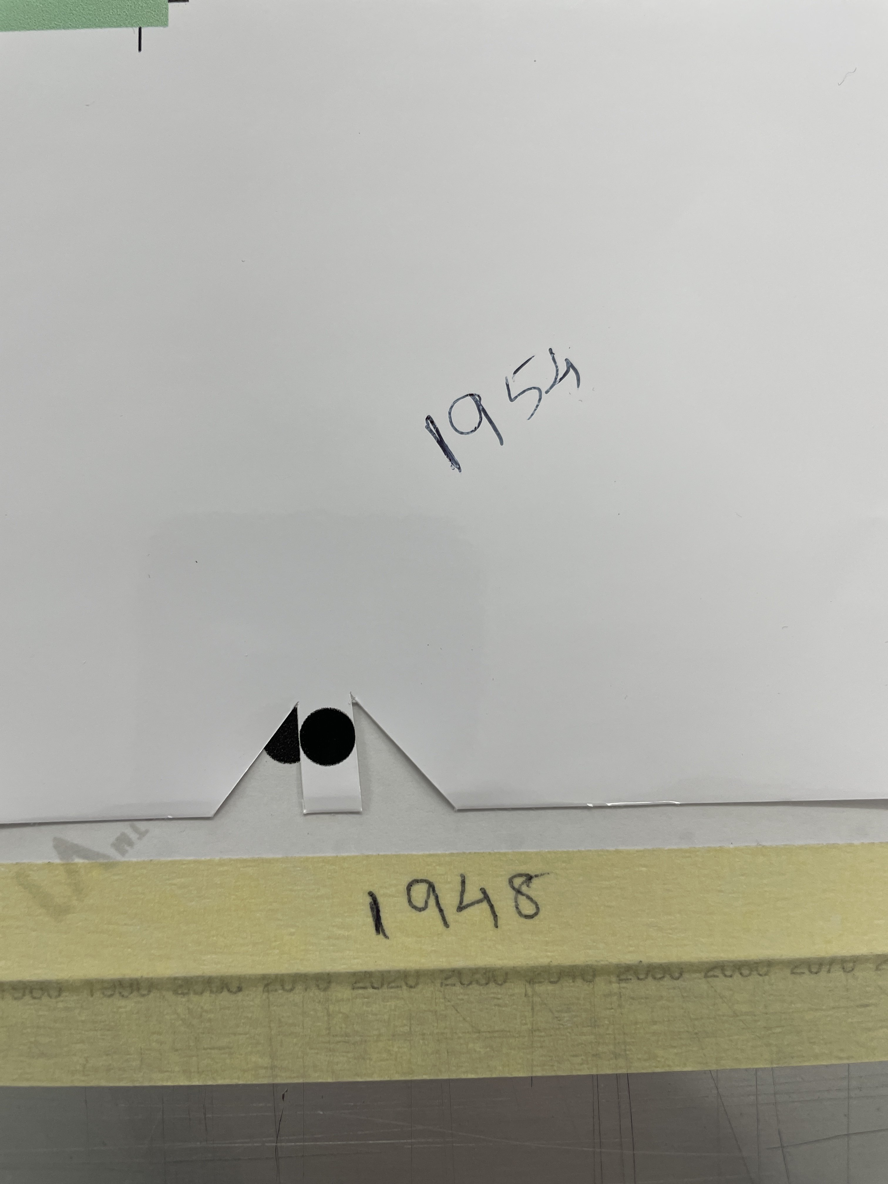

We've had barely any issues with tiled files for around the 6 months. - Now the past 3 jobs have needed re-printing.
The only thing we've done differently is updating the firmware. - Surely that wouldn't have an impact?
  • OMG / WOW
Simon Peach
For testing, we printed an image on our flatbed and the same file on the HP. - It steps out 6mm across less than 2m.
Across a 3.2m drop of wallcovering, its stepping out by 30mm every drop.
"The case has been escalated with HP". - Great, where does that leave us and production? - It's painful.

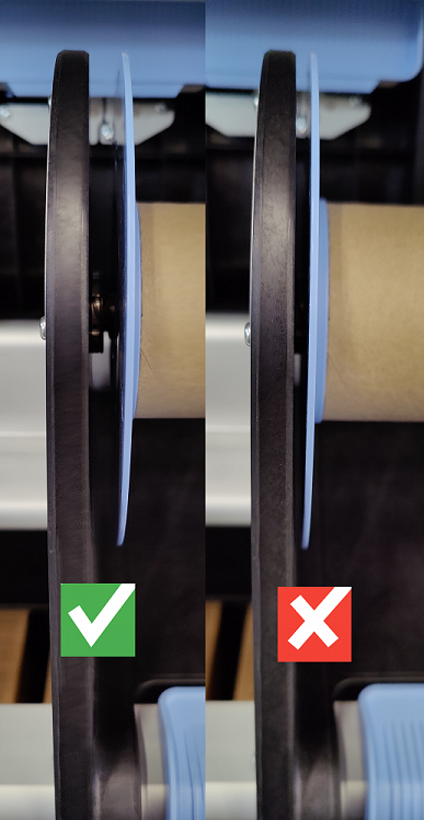

I would also recommend to always loosen up the left end after inserting the roll on it. Don't leave it with full pressure, just click the handle gently and let off most of the pressure.
Especially on the take-up, it doesn't always move correctly if the end is pushed in completely. You can hear audible "click" sound when it spins and that's bad.

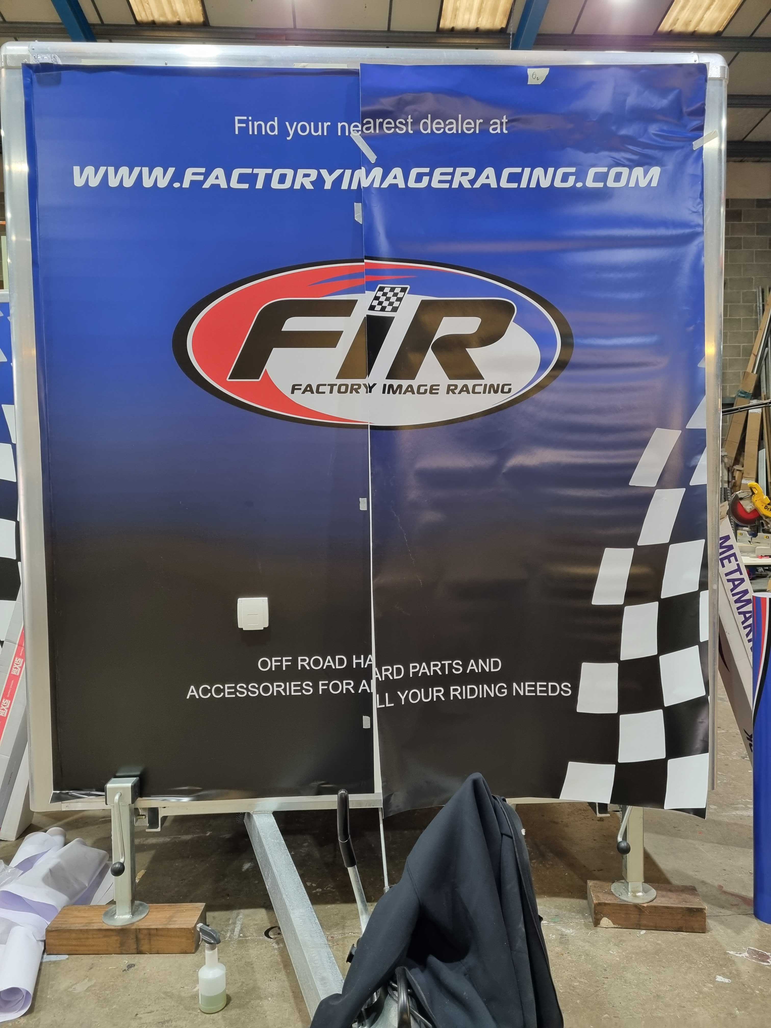

That's horrible! how can it be off at both the top and bottom but in different directions?!
if you stretch an image taller, then measure from the middle - are the dimensions of the top and bottom off in different directions? it looks like a simple y-axis length increase. Could be caused by tension, heat, or combination.
Simon Peach
Honestly, no idea. - Our rep suggested we had stretched it by over-tensioning it on the laminator. - If you managed to get vinyl to stretch 30mm on release liner, the two would separate.

Our final straw was when we had a huge fail with the alignments on a recent wall covering. -. We had to strip off the wallcovering and pay for decorators to make good and paint the wall again before running all 140m again on our Arizona.
Same file, same rip, same method on an 11 year old machine. - the prints were spot on throughout. - don’t let HP waste your time and material blaming the rip
