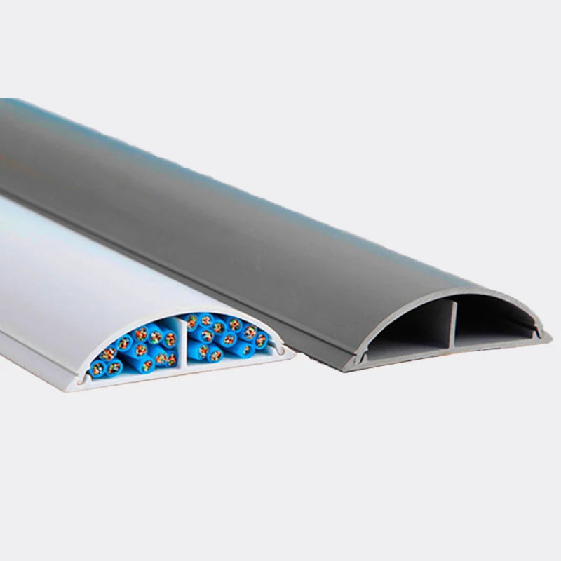

Pendant outlets hanging from chain from the roof or ducting on the floor:
90x25mm-Large-Size-Floor-PVC-Cable-Duct-Cable-Trunking-Floor-Cable-Cover-Floor-Wiring-Duct-Cord.jpg

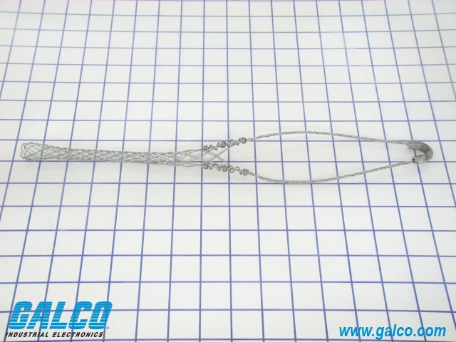

I found these bus drop supports. Do you think they will work? I'd like to hardwire an extension cord into a rafter mounted box and use this to hang it.

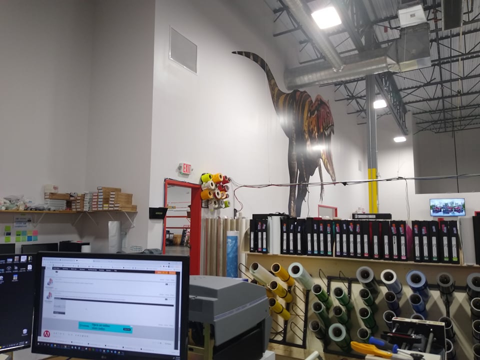

We have 25ft or so ceilings in our building so it is problematic to get our plotters to operate off the RIP and not have cords all over the floor. We took some conduit pipe and hung it about 8ft off the floor from guy wires. Then we just ziptied the wires to it from the PC/network/power to the plotters. Works well and is moveable if necessary.

When you say machines, are you talking like bandsaws/saws/heavy equipment, or printer/plotter stuffs?
Our shear and brake are hardwired with conduit drops but everything else is on wheels. I change my mind more than my underwear so flexibility is good but without cords all over the ground, they are driving me nuts.
