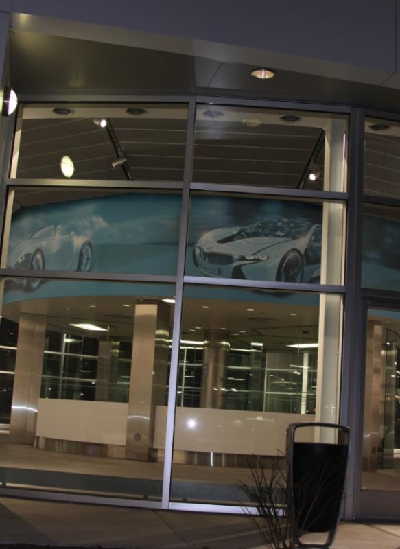

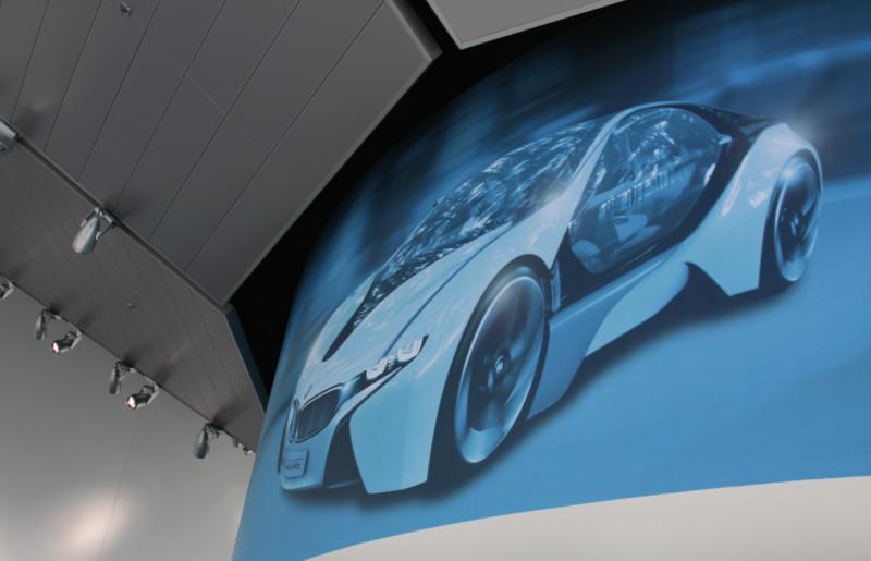

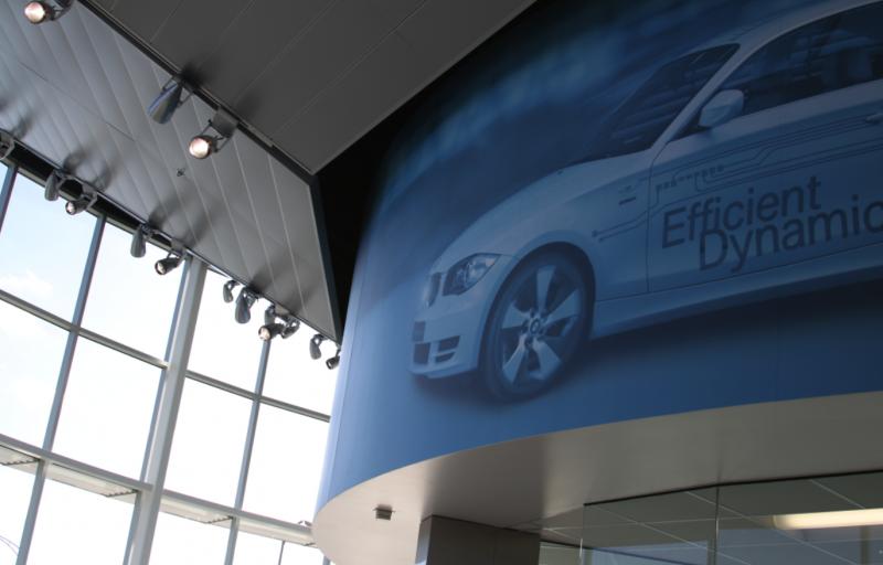

i still wouldn't use 3551RA for vehicle wraps as I'm in LOVE with 3M180Cv3, 3951RA I would, but flat/simple curve projects this stuff is ideal for. I just did a 9'x100' circular wall with 3551RA recently and it worked like a dream:
