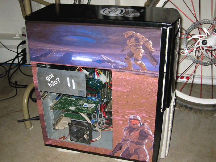

Get a DE"ha"LLo.
I hear they are bullet proof just ask the little dudes going all comando on it. :thumb:

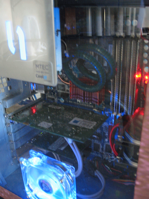

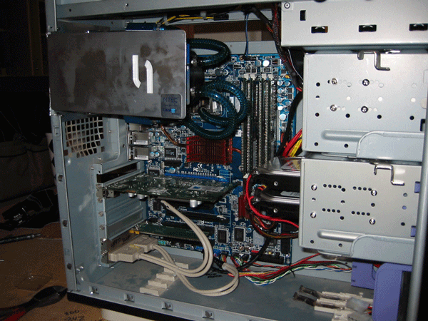

bullcrew
here it is with the cover off.
