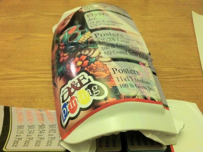

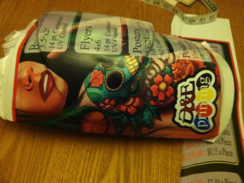

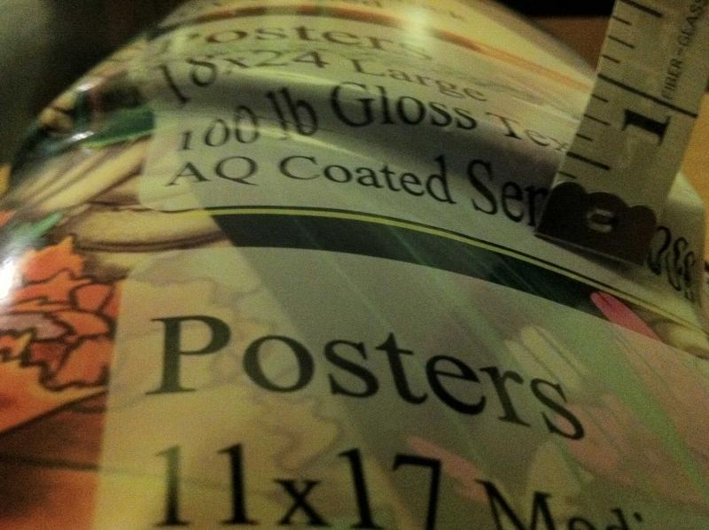

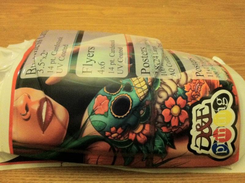

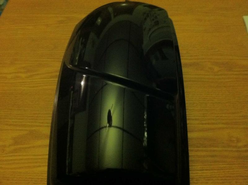

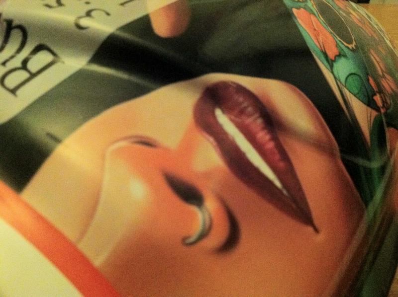

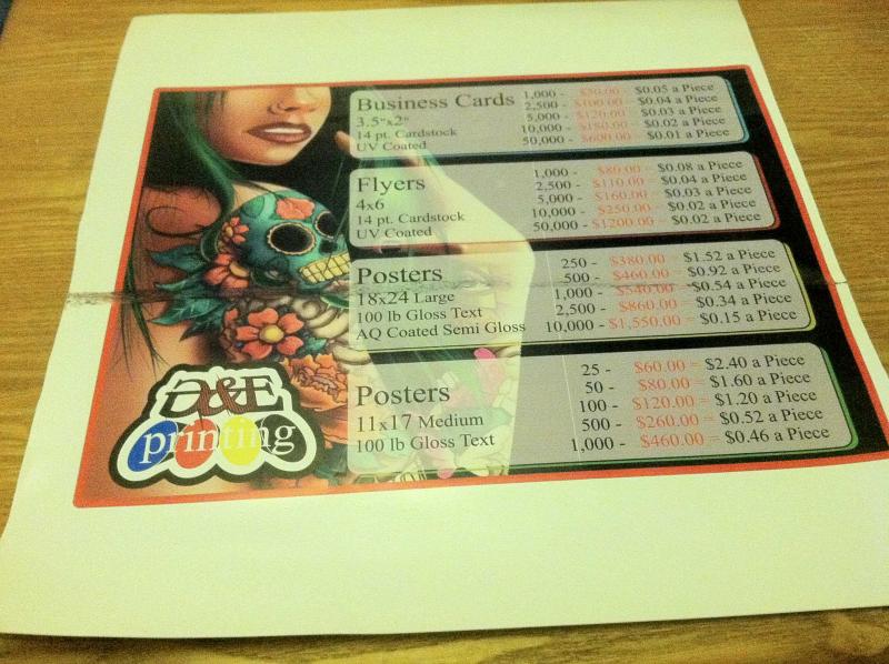

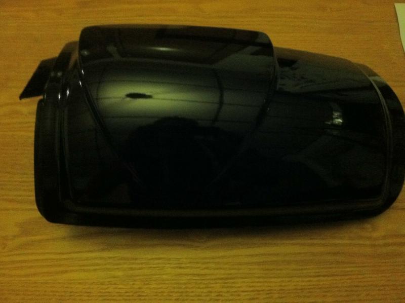

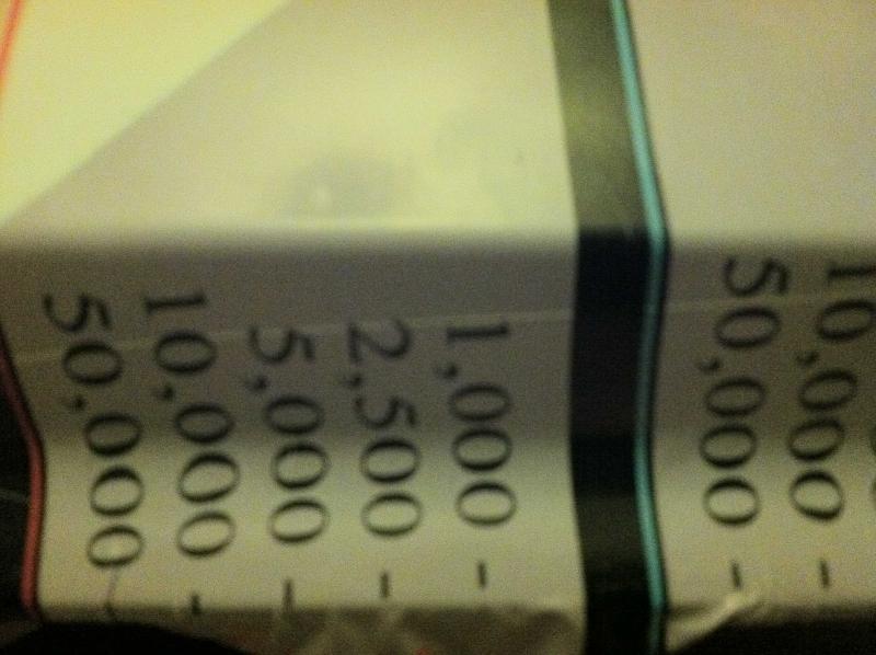

g&eprinting
OK

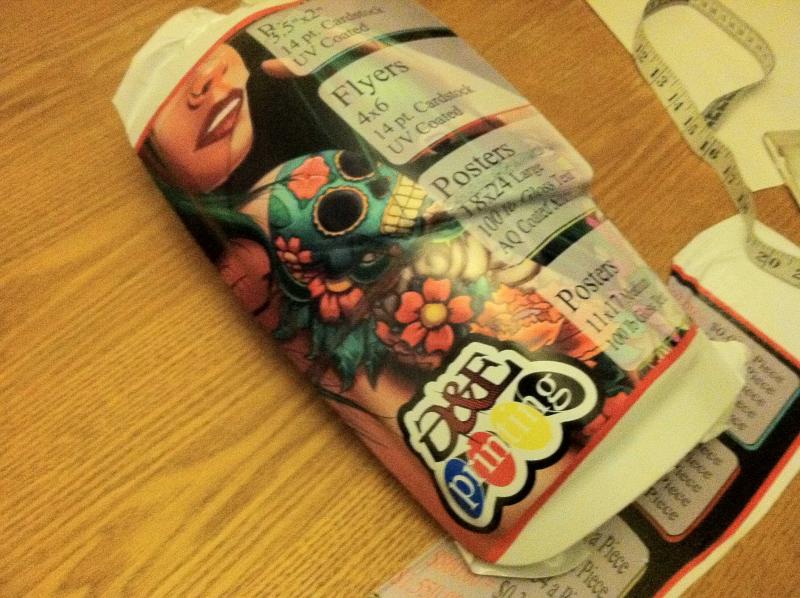

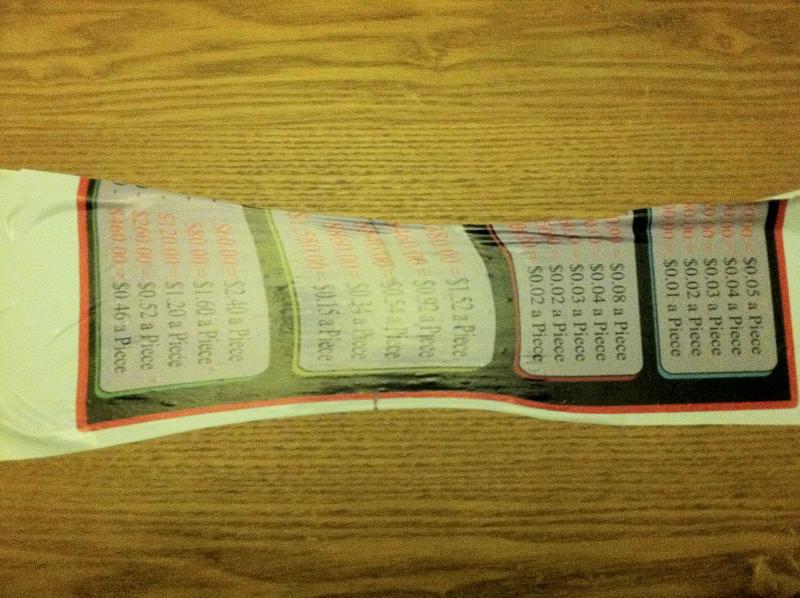

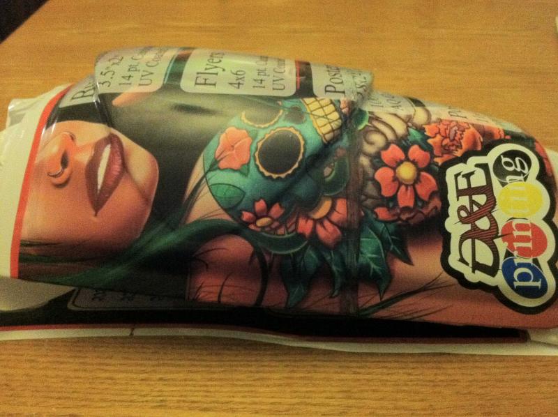

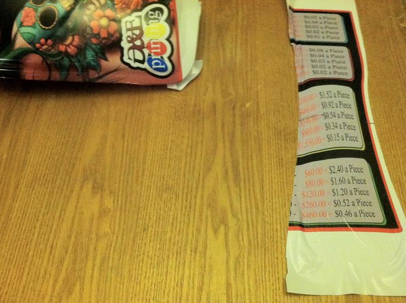

This stuff is pretty good.
No lamination
Oracal 3651 profile on Mutoh.
The color came out better than the pics.
Good stretch.
Doesn't feel too tacky until it hits substrate.
Was able to reposition.
Feels like LG vinyl.

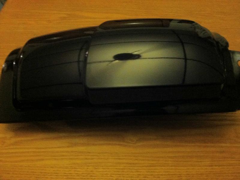

Good half inch drop on blacked out Expedition tail light.
What do I know... Here's the pics.
First pic original file. Color matched real well. Pics not showing true color.
Caught a nice head strike, should have flattened out the vinyl first.
