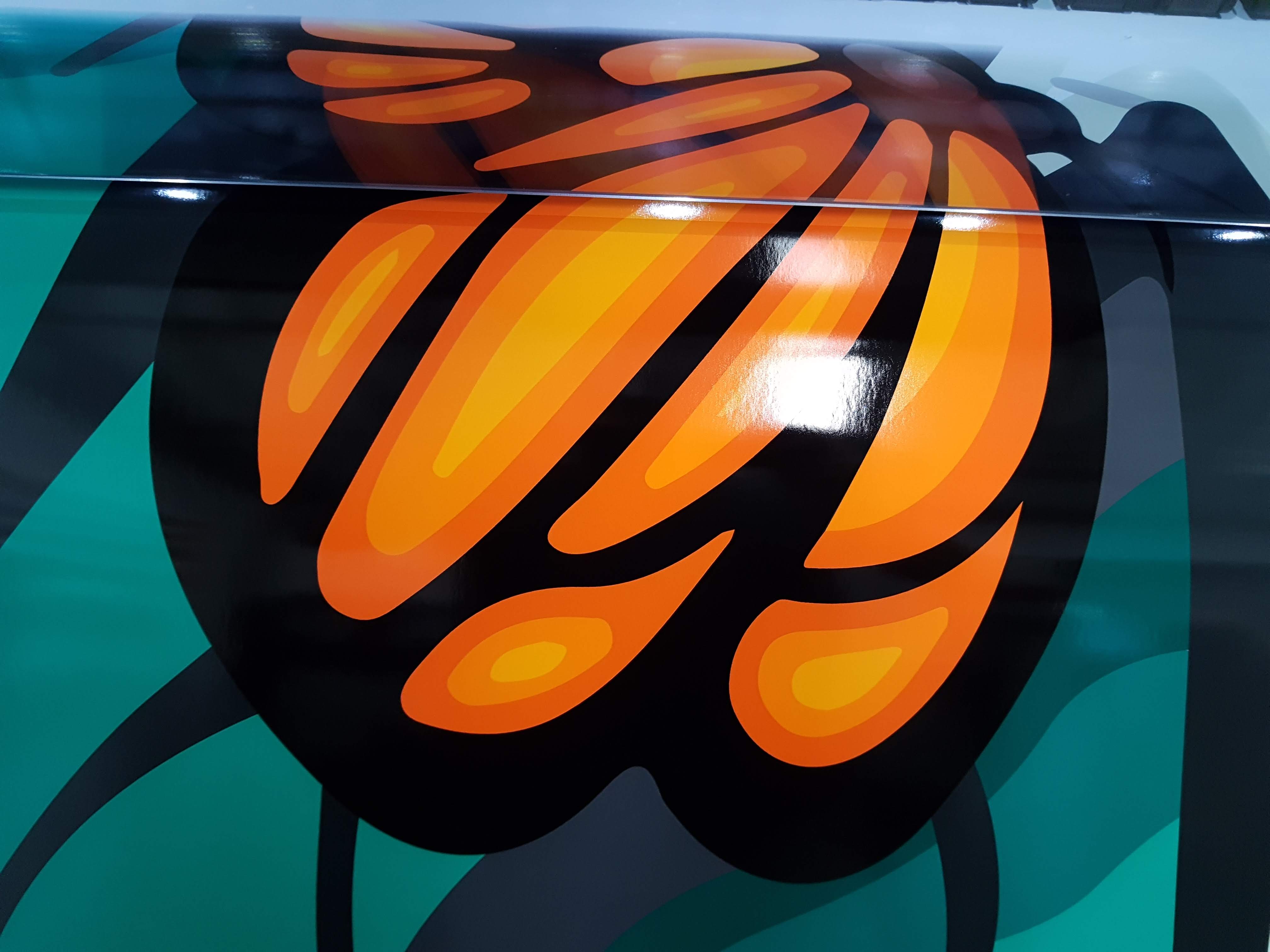

We don;t use the white or silver, but we find the orange/red and light black ink help the gamut a ton, we have only ever run Roland machines before and the quality on the epson running 6 pass blows the roland running 18 pass out of the water.
I have some photos showing how bright the orange ink is and how vibrant the colours are, but I would need to email them to you as the mural hasn't been unveiled to the public so I don't want to post them.
CanuckSigns
Actually I found this picture from the mural while it was printing showing the orange, the pic doesn;t do it justice, the orange is almost neon in person
