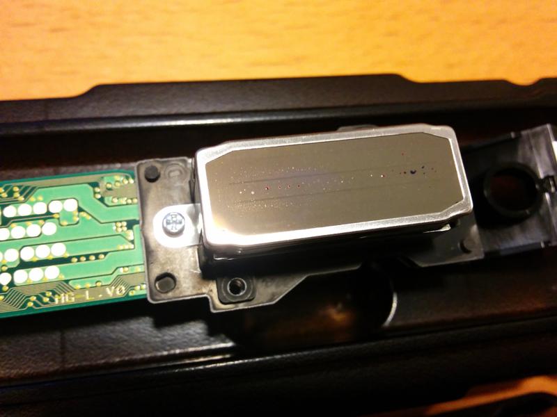

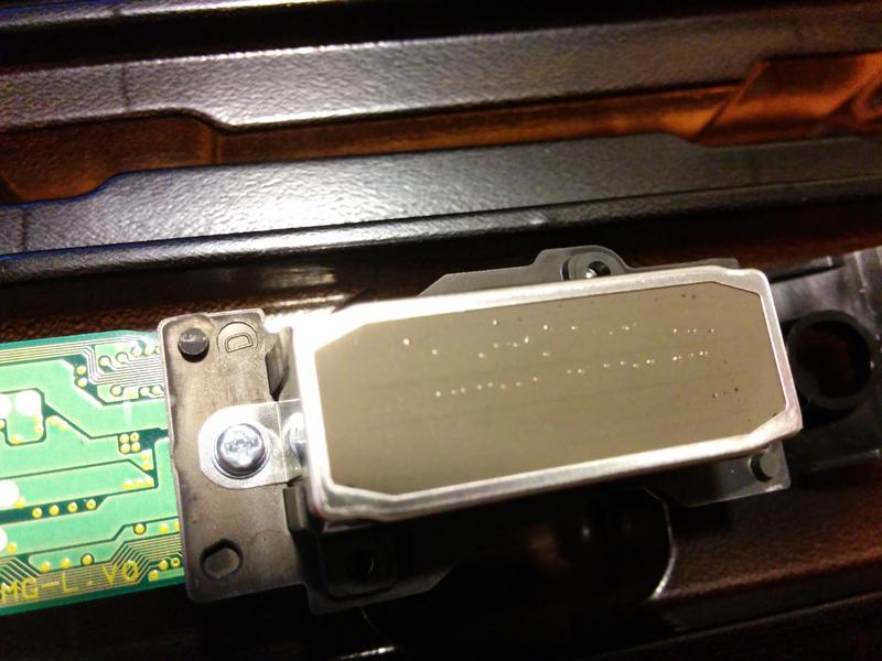

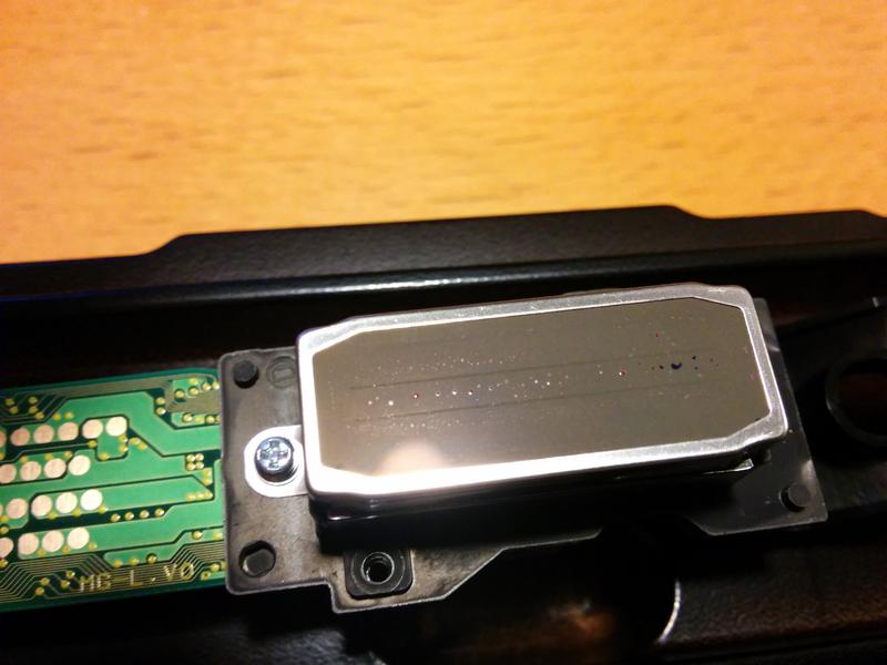

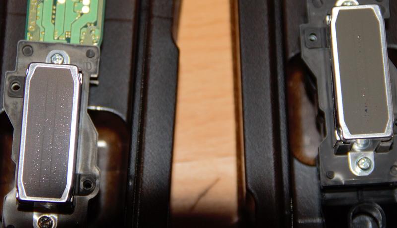

We bought a couple of new printheads online. Attached are the photos. There appear to be some shiny dots, and some droplets. Should I send these back?
Also attached are some PDFs showing how to replace the print heads, from those who've done this, any comments, suggestions, clarifications or recommendations?

The clear dots are totally normal most heads ship with liquid in the print heads . Have you ever replaced a print head on this machine before? If not I wouldn't recommend doing it yourself.

Okay, what about the not-clear dots on these photos?
We had two of the four heads replaced last month, by an excellent technician. Unfortunately the remaining two heads also need to be replaced. I paid attention, took notes and discussed the install process with him. I'm pretty sure I can handle the mechanical part. The PRINT ADJUST process I'm a little less confident about. I have the maintenance manual, but the documentation on that seems skimpy.

hmmm... it's a bit tricky to say. i believe every head is tested by epson. epson keeps the best heads for their machines, and ships the rest of them to other OEMs. this would no longer apply to the dx4 but it's true for all their heads when they are the latest version/model. i'd assume that in order to test the head you might need to insert some test ink. after that, they would fill the head with retainer fluid. maybe they inspector was rushing his job and didn't purge all the test ink from the head when it was on the bench? the head looks pristine. doubt it was ever installed in a machine.

Looks exactly like my recent new head. Mine had magenta coloured fluid (not ink) droplets on the head. I think it's the shipping fluid - nothing to worry about anyway.
Thanks, that's very reassuring.
The dropplets here are magenta. Hard to tell if they're dry or liquid. They don't seem to move.
Should I drop cleaning solution on them, or just ignore them?
