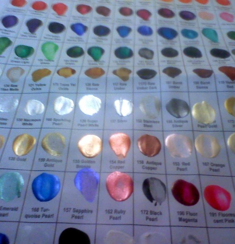

Jillbeans
It's a bit of a learning curve, but I thought Nova was nice because you only needed soap and water to clean it up, and even though a few colors required double and triple coats, the drying time is really fast.
The colors are gorgeous, and if they last long, which they are seeming to outlast 1Shot, that's great.
There are two additives that I call "semen" or "snot" and depending on your painting condition (hot and sunny, smooth or rough surface) either help a lot. I would not use water or Pledge with them though.
Also like that they come in plastic jars with twist-off lids. And their color chart is indeed cool.
I think I will gradually be switching over. Thanks to Craig's help and the loan of his brushes, I was able to get along OK with Nova.
Love....Jill
