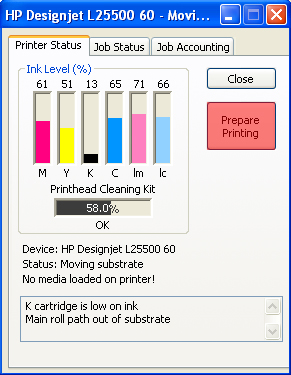

Are you sure? Because I'm pretty sure when I click "Prepare Printing" it fires up the heaters on the machine.
Check my screenshot with the highlighted button (Onyx 10). Have you tried this?

Yeah, we're on 10 as well and whenever I hit this, it kicks the machine on. From sleeping or hybernate or whatever but if you check your printer, all it's doing is initializing mechanics. It still takes the same amount of time to warm up. And it doesn't fire those up until you hit print and it starts to recieve data. At least thats what I've found.
However I don't know how to check temps on the machine from the menu yet to prove this therory.

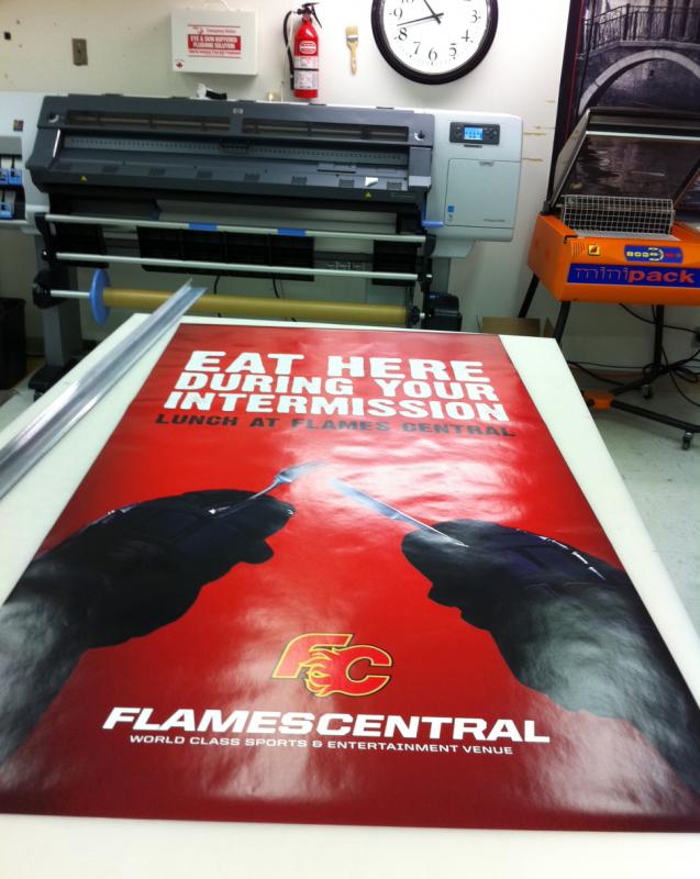

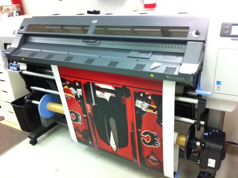

I've been running the L25500 for about 3 months now... I just love it! :loveya: I've run quite a few medias through it and only found a couple that won't work too well, and that's because they were formulated for solvent. I hardly use my Roland these days and am looking at trading it for a 54" cutter. The HP is fast... even with the warm-up time at the beginning of printing. And yes, you can pre-heat while you are working on the RIP, just like drs6222 mentioned in the Onyx 10 RIP!
Here's a pic of a print I did yesterday last week, and I'm running 8 more today. These are 36" x 72" and printed in about 10 minutes each on 12-pass. The stock is 7mil Latex Poster paper from Big Fish, and it runs like a charm. I have more on the way to me as I type this! Excellent media and a phenomenal printer! :thumb:

I'm still not sure how you all think that the exclamation point kicks on the printer to pre heat - I have yet to see a differance in kicking that on or just hitting the print and letting it do its thing on its own. All I have seen is that it pulls the printer out of sleep mode if it is in sleep mode. Please, if there's more then hitting the prepare button please let me know cause I'm not convinced.

prepare just brings the temps up to a "ready" state, not to the print temp. This feature is WAY more important if it is 50 F or less in the room and you are getting ready to print.
I used to get the same issues with my seiko CP64 on really cold days... but I didn't have the prepare button then!

Well, you're probably doing it wrong! Are you standing on one foot, rubbing your belly and patting your head while you click the button?:rolleyes: Oh wait, you'd need a free hand to do that.... dang, let me get back to you!! :ROFLMAO:
No really... I think what MachServTech said is probably accurate. Still, I don't mind waiting for the warm-up period... it still kicks the Roland's butt in speed!:thumb:
