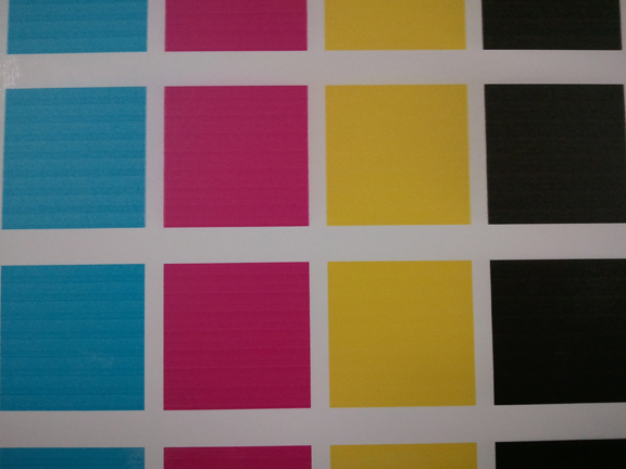

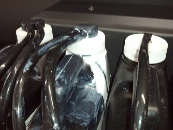

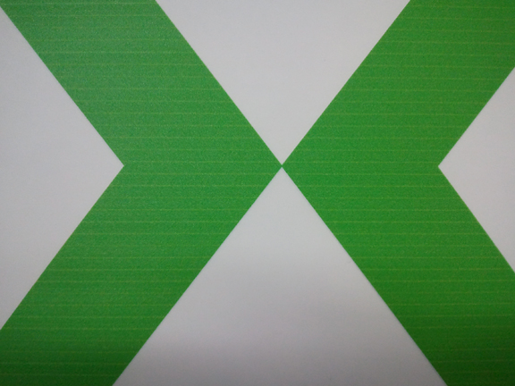

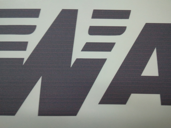

Our company just had this printer set up a week ago and we are having some issues. The main issues being striations or (lines) in our prints. See pictures. Our white ink is also leaking onto our table. We have only printed a few things and they were either on vinyl or polycarbonate (we eliminated any static electricity of the material before printing every time). We have also purged white and color multiple, multiple times and then vacuumed the excess drips from the heads with the provided vacuum exactly how we were trained to do. We continue to purge, clean and run JET ID tests and still are getting these lines in our prints. We have contacted Rastek but were only told to try what we already know and have done. Is there anything else we can try? Any help would be greatly appreciated.

Whats your temperature and humidity directly around the printer?
That looks like a static issue.

Just a dumb question, but what's the condition of your compressed air supply? Do you have an in-line drier and water traps in the line to prevent condensation?
We have a Vutek QS3200 and ran into issues with white ink dripping because our line had too much condensation and we didn't notice. Even the local Vutek techs missed it at first, until we got one of the senior techs out...

one tihng I'd look at is the negative pressure on your white. Check the monometer and most likely adjust it ( increase it a touch) negative pressure with a UV system is tempermental ( and it will be with all models) and can sometimes be affected by a huge shift in air pressure. If your JetID looks spotty, with nozzles out, then most likely this is the cause. Hang in there, you have a good machine, it's just the initial can be a touch finicky. It's kind of like a new GF, you need to know what she likes, then once you know which buttons to push, she'll give you what you want. ( adjusting negative pressure, head gap, and sufficient nozzle purges to give you a good print)

We have had the same issues on a brand new 650. We were told to do the same as far as purge and vacuum. I wished I could have been able to return the machine. Unfortunately, I found a solution and continue to be profitable in this new arena. Some tips to help are to remove the air with in the lines of each ink in the am before you do anything. This may take a extra 15 minutes to prep the printer and you may have to do it twice. Purge the ink again then vacuum the excess. Sorry but the most important issue other than the printer builds up air in the lines when it not in use is the humidity and temperature around the machine. Keep a thermometer close to the machine that reads temp. and humidity, keep the temp in 70's and humidity 50 or above. Our best prints are fall and spring. Summer is not bad but winter is the worst because of humidity is in the teens. (North Carolina) Hope this helps...

We have the same printer and were experiencing the same problem early on. After multiple tech visits EFI finally sent 2 engineers who went over the printer with a fine tooth comb and found the issue. Are you heads getting too hot while printing? That was the one thing we consistently saw with the drop out was that our heads would go yellow on the tending screen right before the nozzles would drop. They would regulate themselves back down, but only after the print was ruined. This turned out to be a software issue and no amount of tinkering with the pressure will fix it.
That being said, with you ink dripping out it sounds like you definitely need to increase the pressure on your white heads. Only do it in small increments however, as you don't want to pull air into the lines. As far as Rastek goes, we have had a great experience with their tech support. Granted, my printer still has issues, but they are quick to respond. Send me a message if you need more specific help.
