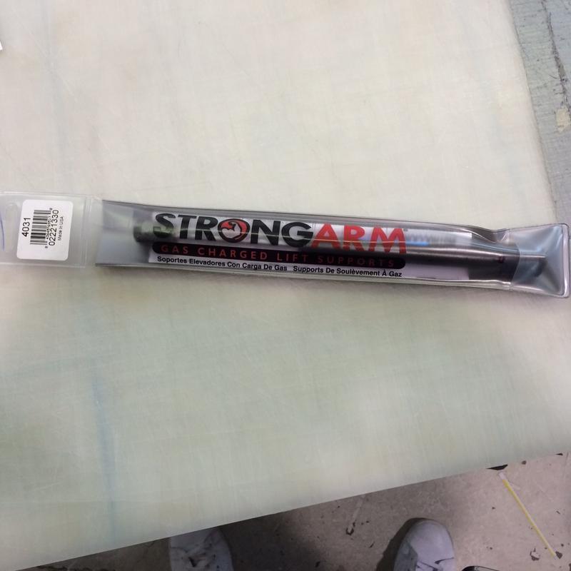

I have a friend who recently bought an older edge LE. He called the Gerber distributor up here in Canada to get a price on the shocks.... $200.00
He now sends me a pic and he paid $40.00 at a car parts place...... wow!!!

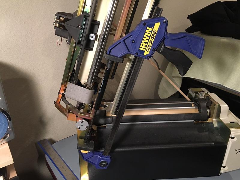

Jburns
And use one of these tool clamps for a easy installation!
