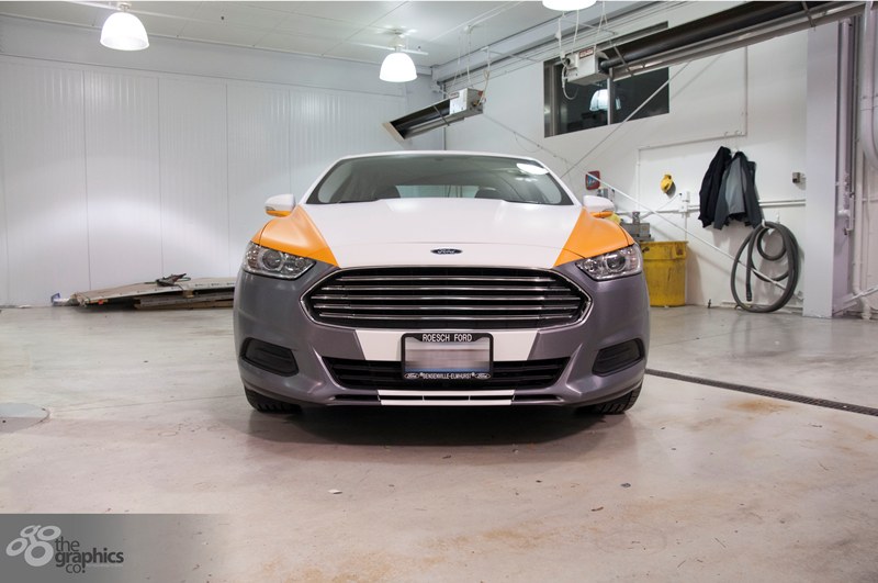

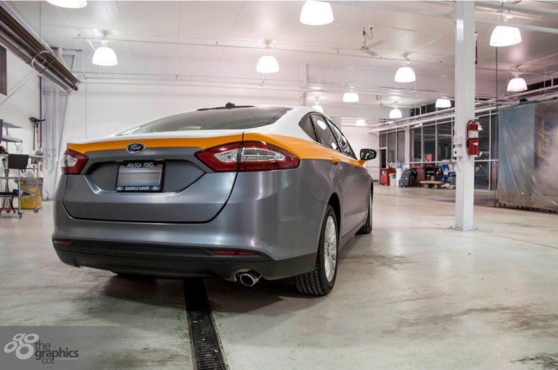

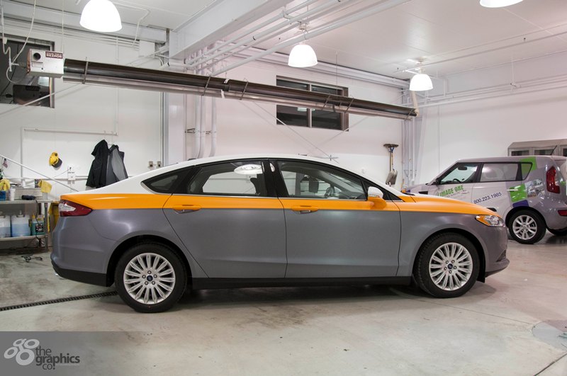

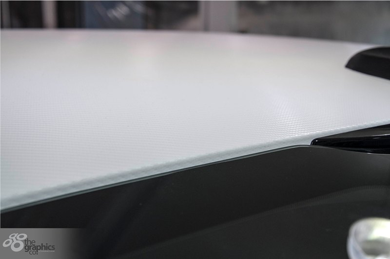

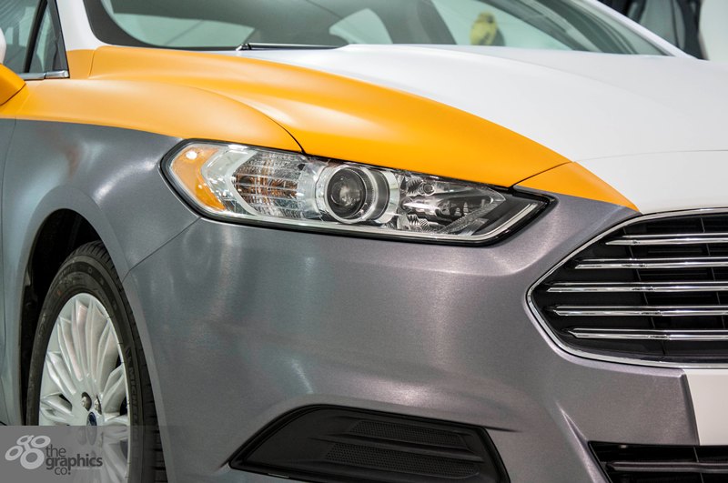

New Shop Car Wrap!!
the graphics co
Just need to put the logos on!

Great match of colors.
Does the 1080 in brush finish apply as easy as any other 1080 films on contour such as the rear portion around the plate?

It works well, no issues with the license plate pocket or the bumpers. The only thing is it is a bit more prone to tearing so you have to be careful when you are doing relief cuts, if you put any strain on your cuts before it is stuck down it it tears right down the grain.
That looks great! Nice flowing lines....very tasteful compared to most "wraps".
Thats a new fusion right? I love how the front end almost looks like an aston martin.
Thank you. Yes, it is the new fusion. I love the look of it, definitely a little aston martin inspiration in there and it gets 40+mpg.

very clean and simple. Do post some finished photos
How big is that work area and very clean, congrats?
what are the big containers of blue under the table?
the graphics co
Did you overlap where the colors meet? If so how much? Used knifeless tape?
1/8" overlap down the sides, no overlap on the hood. Knifeless tape for all the seams.

I am partnered with a body shop, the containers are filled with cleaning products, window cleaner, tire cleaner, etc...for detailing repaired cars. Lots of space, that particular portion of the shop is 6 bays, the whole shop is about 75000 sq.ft.
