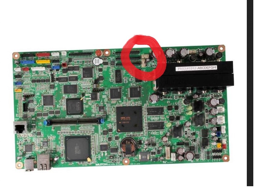

Yes I know how to test fuses. I just can't seem to find where f2 is located on any of the boards. I tried calling the number mutoh gave me for a repair tech but either they got a new number or went out of business.
signage

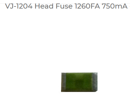

I don't have a picture of the location of the fuse but here is what it looks like and if my memory is correct it has marked by the Fx.
