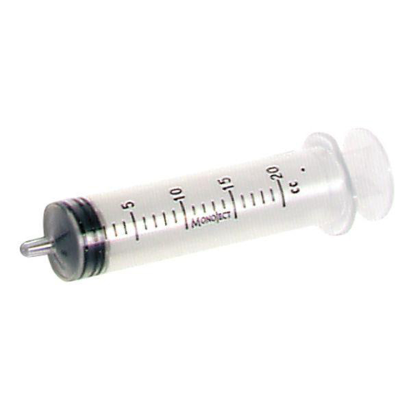

I have used syringes for years when I had to pull in from under the cap tops.

I also noticed more then ever that the ink and cleaning solution we use appears to be attacking the rubber O rings in the syringe and after a few pulls they really did not work very well for pulling ink through the lines.
This last time I really a difficult time. First I pulled ink into each damper using a tapered syringe and then I trying using the syringe on the tubes below the cap tops with the heads parked in the proper place but I could not pull the ink through the lines to save my life!

I could not believe how easy it was compared to using syringes. I don't think I will ever use another syringe again.

One of the has worked just fine for me for the last 13 years on my SP-300V, about 2 bucks from your local feed store.
