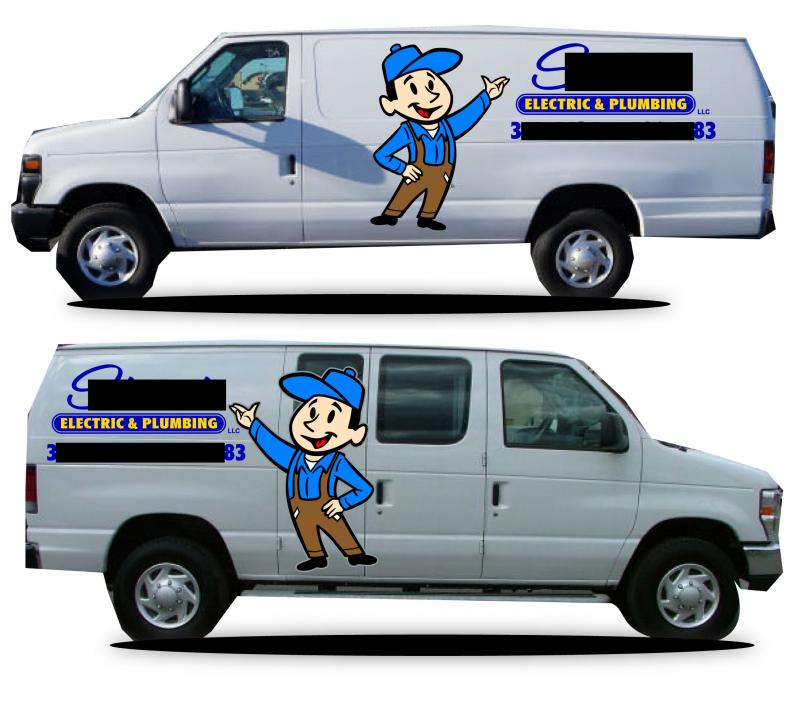

I'm sure this has been covered in the last 8 years I've been a member, but I was never much into vehicle graphics. I've done my share over the years, but have always avoided wraps or difficult areas (unless a trailer or box truck).
my questions.....
1. On the passenger side (given the small window coverage), would you use perf? I'd say no, in this instance.
2. What about the rubber molding? I've seen where others have gone over this rubber molding, and its cracked and peeled (standard vinyl....not print media). Whats the standard practice? If you go over the molding, is there a prep?
FYI. This customer has always insisted on "only the back 1/3" of his vans (he likes that $300-$500 price range......SUPER CHEAP!!!!!). I WAS able to talk him into a little "attention getter" on this one. This is my first rough draft to show him.

if this is your draft, pay attention to your layout. You got two different wheel bases or the extended option in there if your scaling it.
Customer hasn't even took possession of the van yet. He told me the van was a 2012 leftover....Had no windows on the drivers side, but did have glass in the double doors passenger side.
Me: www.cars-dot-com.....search perfect side view pics of a 2012 E250.....clip as fast as possible (customer won't care how well I did).....overlay graphics.....notice problem on PS glass.......add shadow below van, cause the tires were really square on the bottom (haha....oops).

just wanted to point out one van is longer then the other in your sketch in case you were printing from it. Those vans have 2 different wheel bases and the 3500 has the extended rear option.. which you have one shown in your sketch.
Plus the door on the side can be double doors or one on a trac that rolls back to the rear on a trac... sorry. I should not know that much, but i do and it sucks so i'm sharing.
I haven't done a sketch like yours before, but i'm sure you would be fine without the perf unless they want to pay for it.

I will preface these answers by telling you that I'm in about the same position as you in that I do not specialize in wraps or complicated vehicle graphics but I would not use perf in this case. I would only use perf if it was requested, if it was necessary for visibility or perhaps if it just covered the whole window. If it is an economy job then I definately wouldn't consider the use of perf, convex or any specialty materials.
I wouldn't go over the rubber usually, however you do need to go over it when you are applying the graphic anyway so you will have the choice of leaving it or removing it when you are done. You can decide what you think at that point.

1st off.........WHY does the graphic have to be that size???
2ndly..........IT IS NOT that important!!!!!!
3rdly........IF YOU did a better DESIGN OF THE TEXT ...........you wouldnt need to compensate with an overgrown, over used...piece of clip art.
NOW THAT SAID.
start over
work with WHAT IS IMPORTANT sign basics 101
WHO, WHERE, WHAT, AND HOW TO CONTACT!!!!!!!!!! this is why he wants the truck lettered.....not so you can take up half of the truck with an "over used" cartoon guy.
redo the text, make it IMPORTANT....down size the guy...........you may find something you didnt know would work.
OH...and for $3-500........why waste YOUR TIME giving him something HE DONT THINK ENOUGH OF....... to pay for good design???

I'll try to answer your questions (all layout criticism aside because well...I don't judge at the risk of being judged myself) in this case I wouldn't use perf on the window because he should be using his mirrors to back up anyways. I wouldn't put vinyl on the rubber (even with primer 94) because there's no guarantee it will stay on. Just make sure you mask out the molding in your mockup so the customer can see that it goes through the graphics. If he approves it then you have no worries. It may look a bit odd but like you said its a cheap job. He gets his graphics and you get paid.
Mike Paul
Super Active Member
The black perimeter around the glass on the passenger side barn doors isn't rubber molding its on the inside of the glass so your fine. Cut and tuck there and don't use perf.
skyhigh
you last 3 posters are correct.....moot point, as there is indeed NO rubber molding.....uggg my bad (my picture looked like the rubber molding anyways).
:thankyou:
Desiree made a good point......Just make sure you mask out the molding in your mockup so the customer can see that it goes through the graphics.
