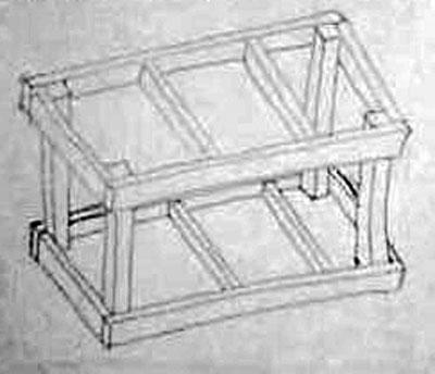

just made another of these in a few hours last month...
need:
(4) 2 x 4 x 96
(8) 2 x 4 x 45
(4) 4 x 4 x 36 +/-
(2) 1/2" x 48" x 96"
(100) 4" deck screws

In my vinyl production rooms, I have MDO table tops covered with self healing mats available from most sign supply houses. In my fabrication area, the one i had built when this thread showed up, I used 5/8" AC ply, primed and painted, & I have an old scuffed up 1/8" sheet of PVC on it most of the time, for a smoother & easier cleaned table, but toss that aside & more serious carpentry or assembly tasks take place with heavy tools thrown all over & then clean up, put the PVC back.. and I can weed vinyl there, slide a $4K HDU sign on there for glue-ups, gilding or smaltzing etc...
