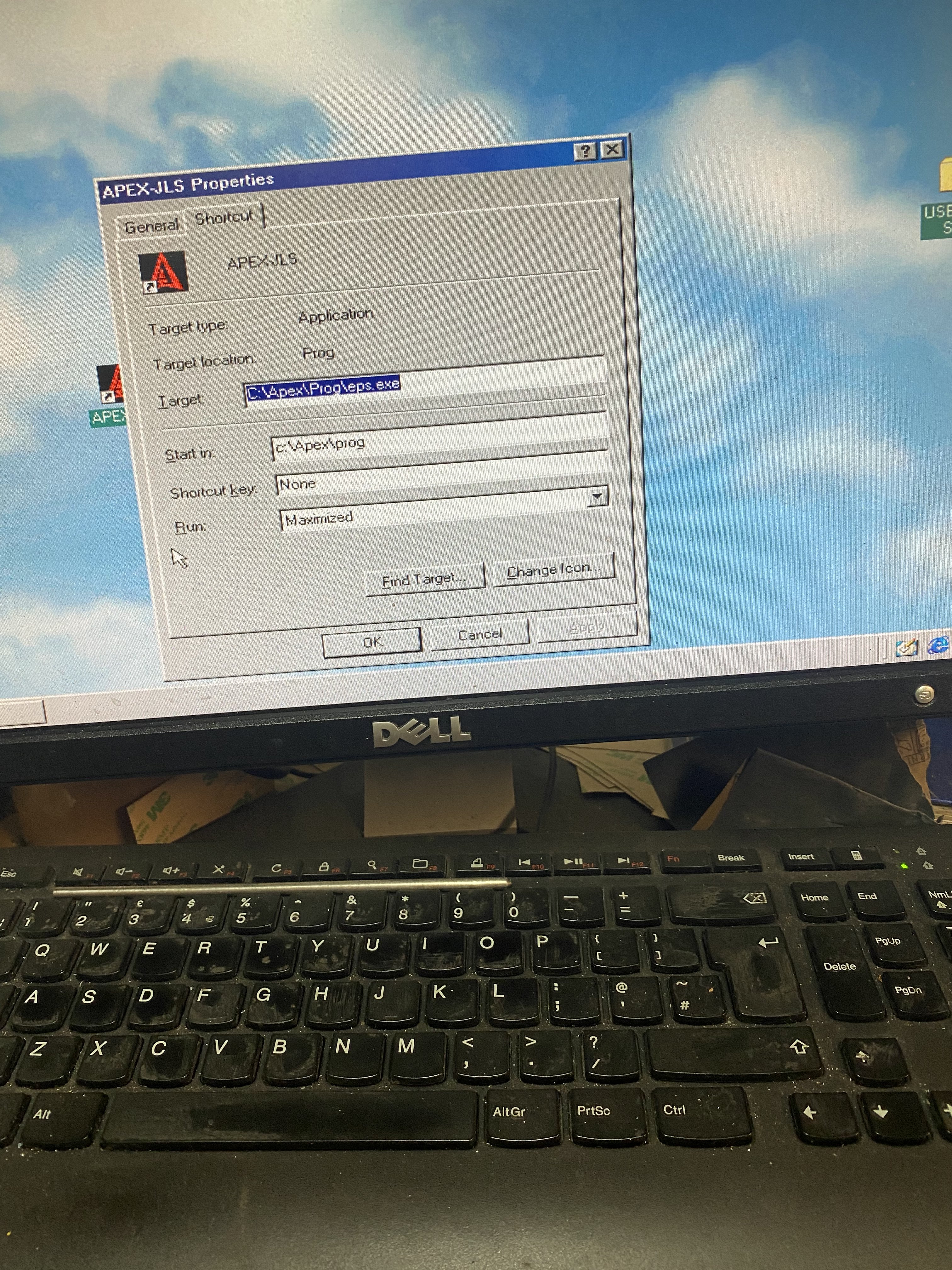

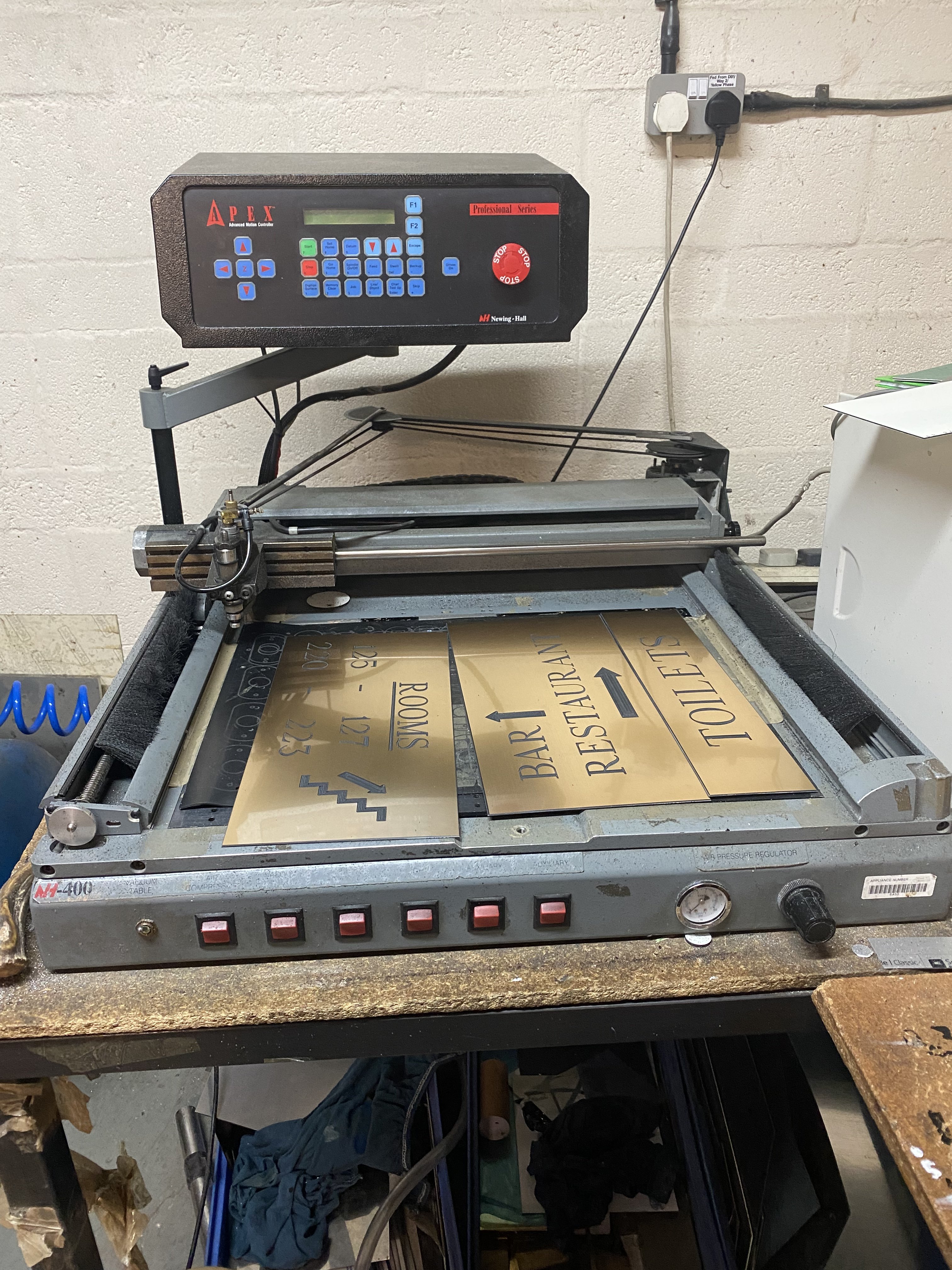

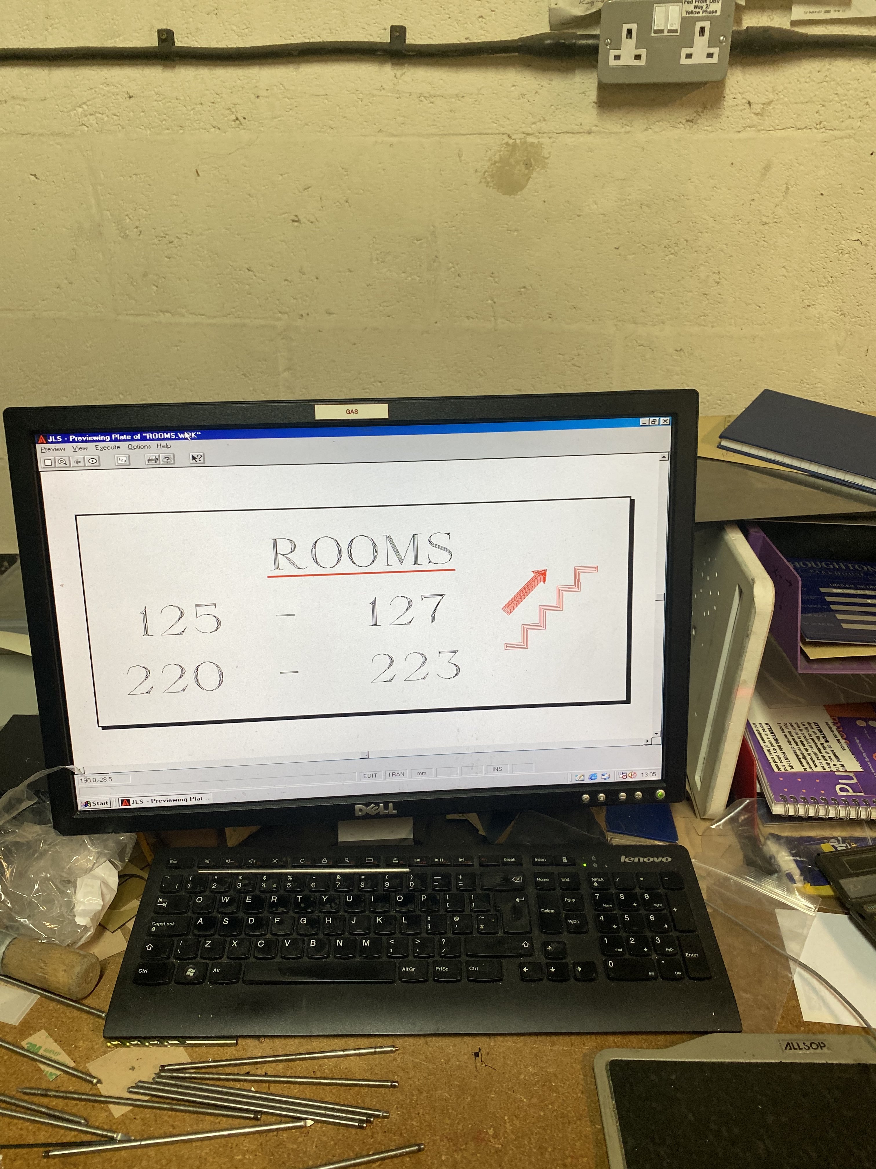

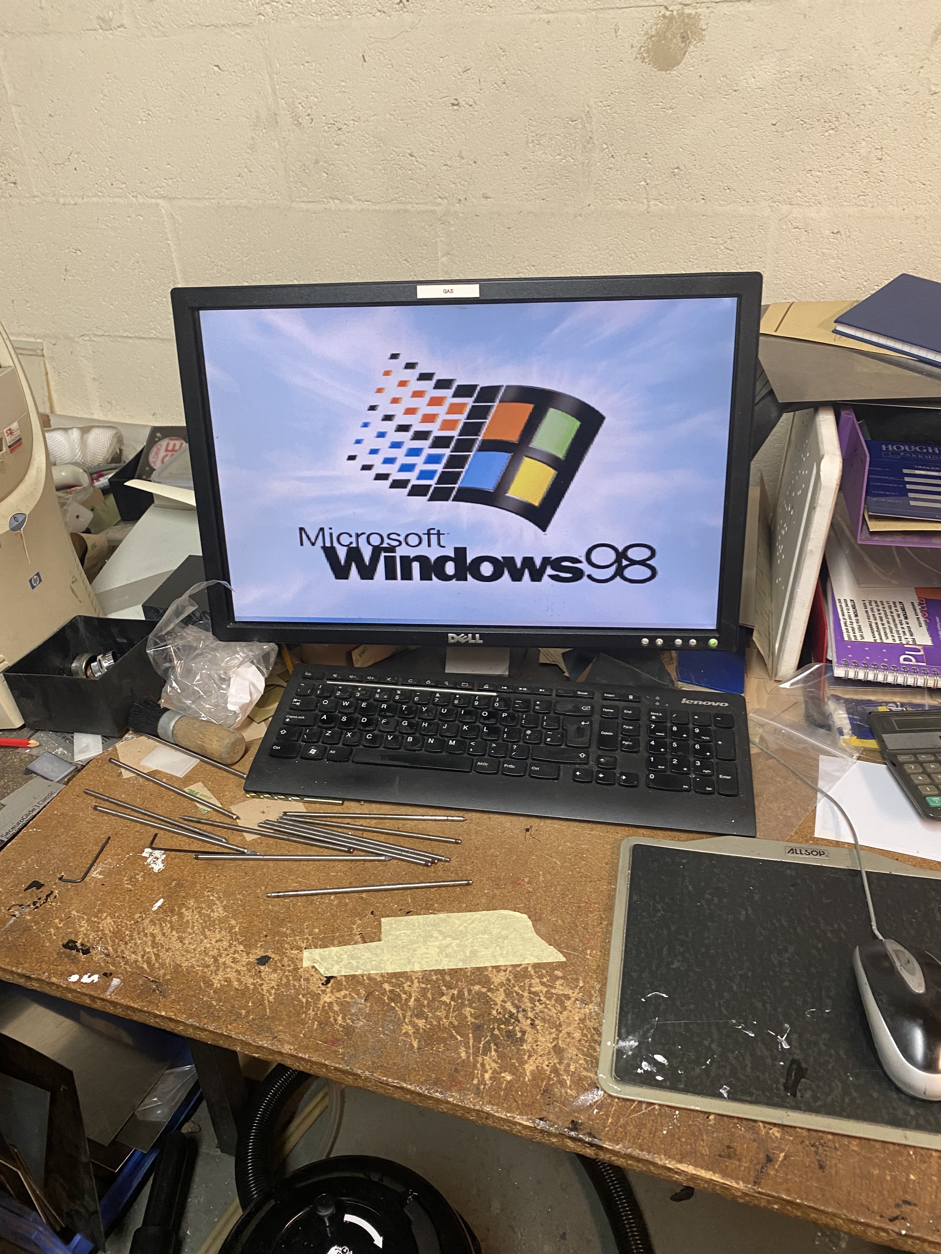

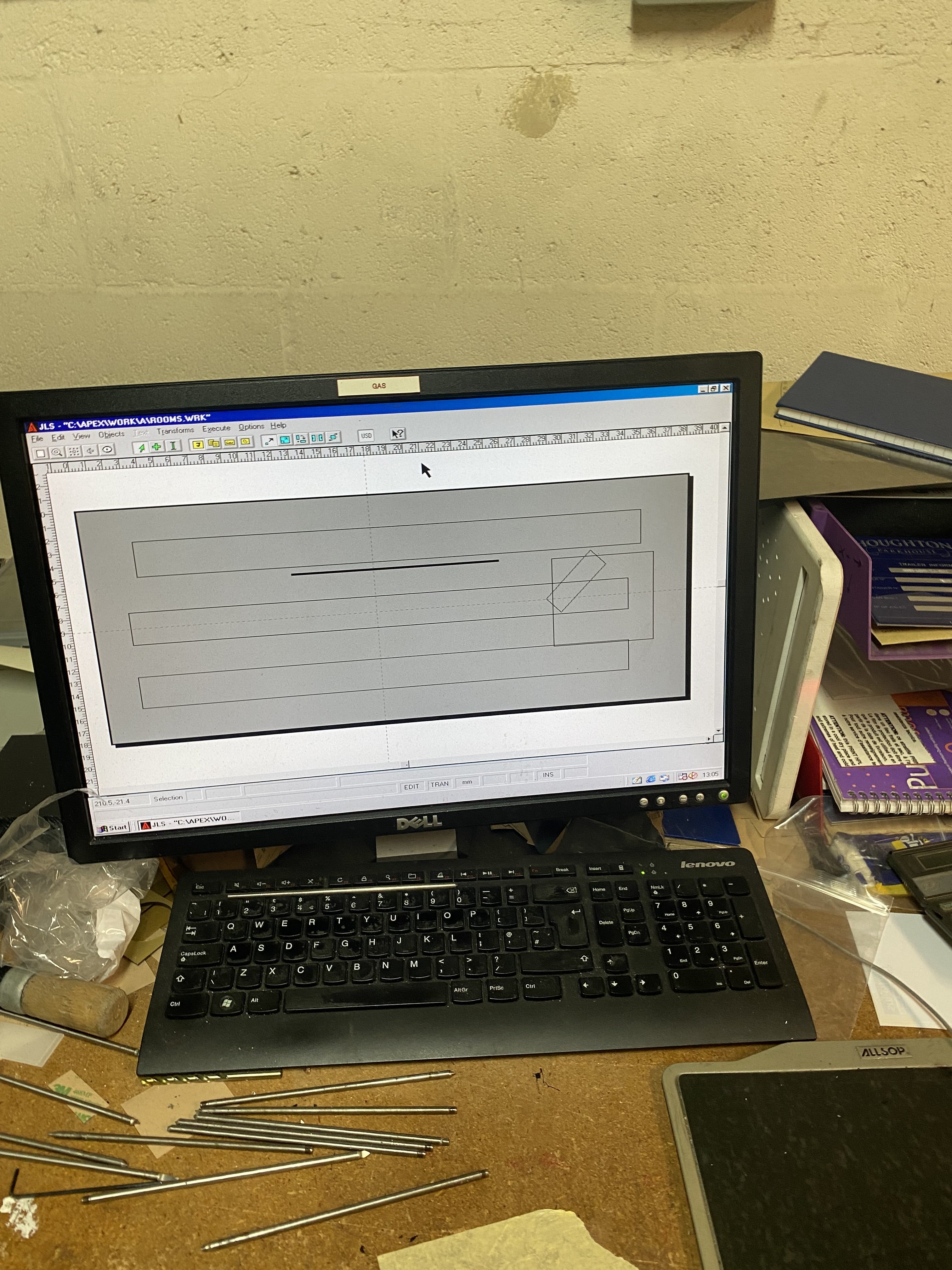

Hi I am in the uk and we have a newing hall 400 we run it on an older version of windows than those you have there I am not in work today but will have a look for you to see what we have tommorrow
Thanks a lot.I appreciate that. This one has 3 cartridges - one for Microgramma, one for Roman double line, and one memory cartridge - it's THAT old! but my understanding is you need a dongle for their software, too.

Roger the Mash
Photos of our newing hall 400 together with computer photo and operating system and program
