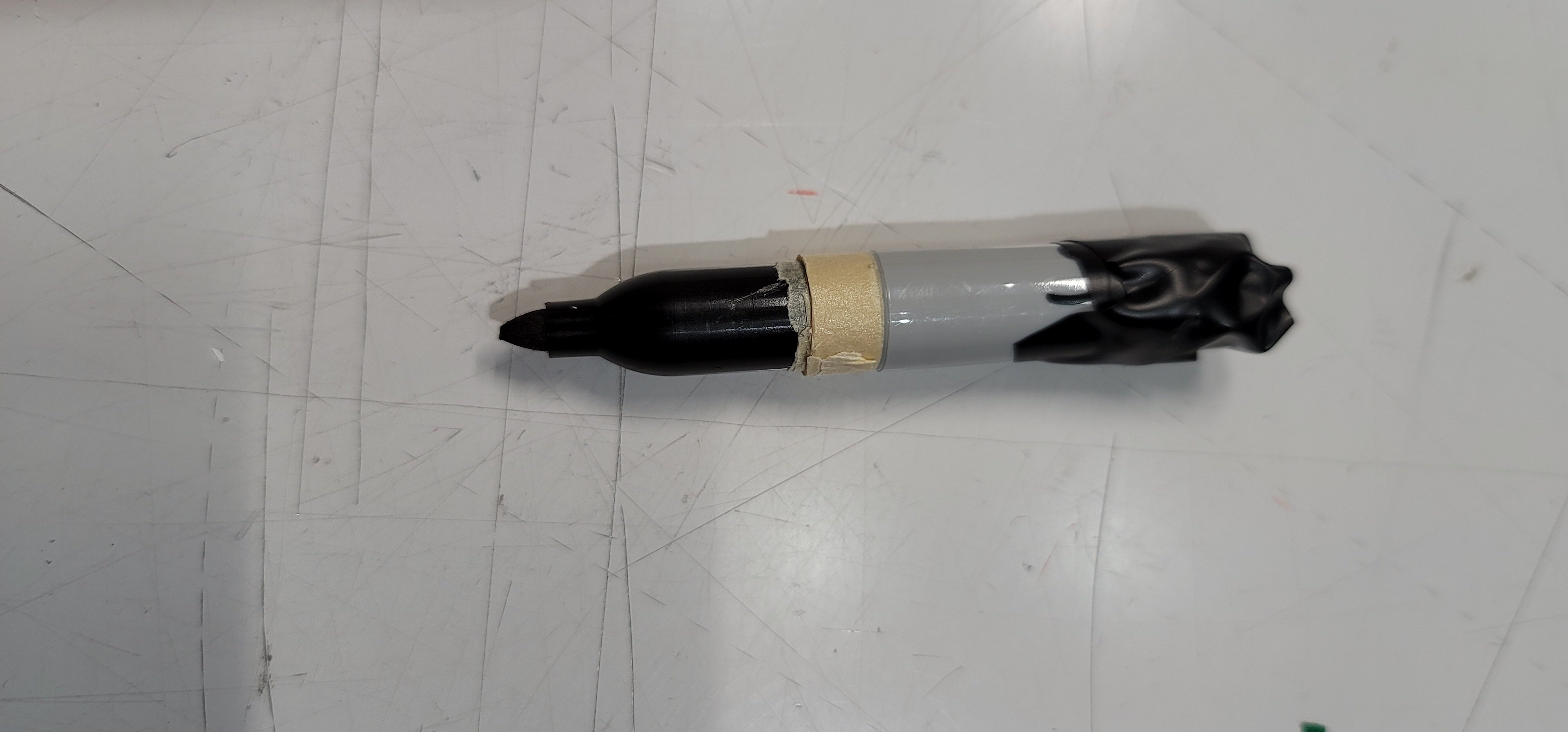

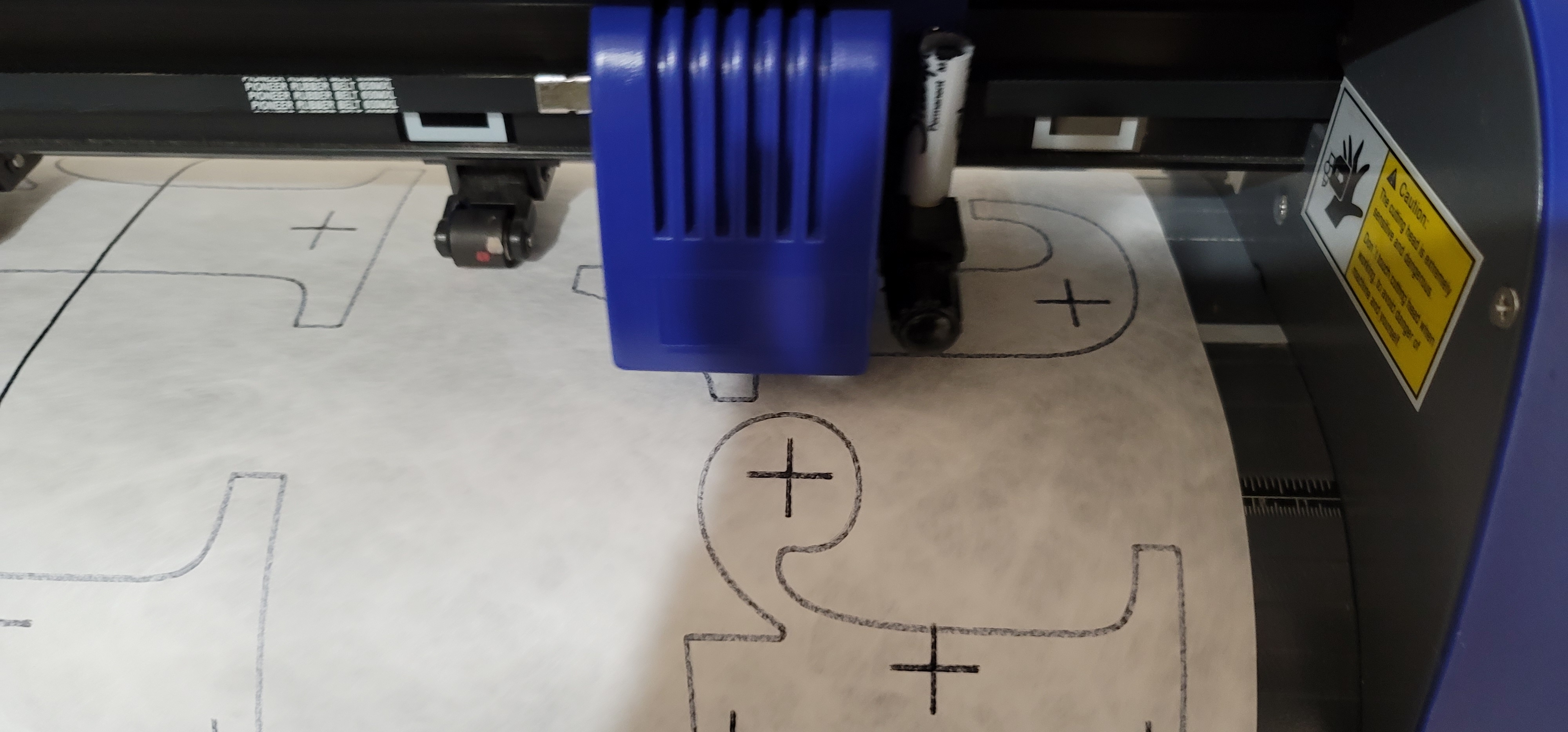

I was looking back at all the Gemini orders we placed and those patterns add up.
Get a roll of tyvek from Uline and make your own.
I cut a sharpie and use it to draw the pattern on the tyvek (pen doesn't work well)
Gemini will send you the file.
At $80 a pop, those patterns add up... cost me $10 in material and a few minutes of time.
