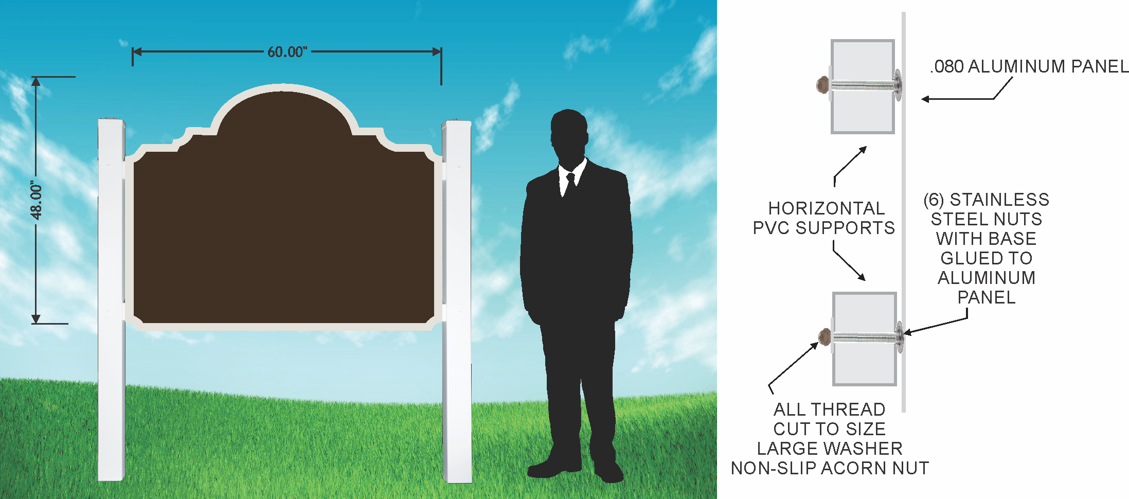

I am putting together a couple of single sided "Vinyl Grover " frames with .080 aluminum panels cut to shape.
I would rather not drill through the panel and leave the install bolts showing, so I'm thinking of
adhering nuts with a base to the back side of the aluminum panel. A couple of questions:

Andy D
That's a great idea, the only downside is the panels wouldn't be removable..
but it would make my day easier, I tend to make projects harder than they need to be.
I have the VHB tape, and my go-to outside adhesive is 100% silicon, what would you use?

I've seen threaded hex studs screwed into a channel that runs up the middle of the posts. You screw the stud in the channel on the bottom and the sign slips into the channel and rests on top of the studs... then you screw two more in at the top and it's held in place.
Billct2
I like that idea. I would probably bend some .063 or 080 to make a custom sized bracket that is the same width as the crossbar
