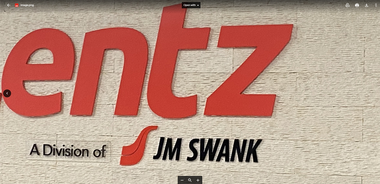

Have a customer that wants us to put some letters up on a wall. Foam core to be exact. However the wall has a decorative textured tile on it and we cannot pin them on. I've only encountered smooth walls and whatnot, except when studding them and doing it that way, but there's no way to stud out a 3/16" piece of foam board.
Here's a close up of the wall in the next room over. You can see, nothing is even and they even used a clear piece for the really small letters. Our letters will be about 9.75" tale with about a 1.5" stroke and all block letters.
Any suggestions ??

A raceway, you could contour cut the raceway so it is hidden behind the foam core
Vinyl slayer
I was going to suggest vhb tape?
Is the question how to fix them to the wall? We have a wholesale client that Does stuff like this... If I understand correctly. We produced some printed, CNC for him on ultraboard. We recommend vhb tape.
SignEST
We used 100% silicone for brass letters on bumpy wallpaper. That looks quite raised though. Maybe our methods were a bit crazy but silicone sure seemed to work for a lot of materials on all types of surfaces. It's cheap too. Few small strips of ds tape to hold it until the silicone sets and it was on forever.
Silicone does not stick to ultraboard very well , unsure what type of 'foam board' you happen to be using.
Jester1167
I think Lexal would be thick enough to hold the letters up until it dries, add a few pieces of foam tape so you can sleep at night, and your good to go. If you are providing the material, Gatorfoam would be my choice because it is more rigid, will cut cleaner, and less likely to get damaged during transportation and installation than standard foam core.
