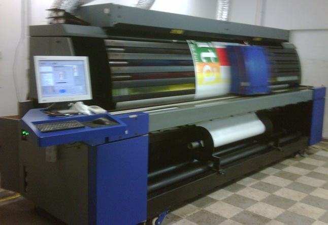

I would agree with the out gassing issues on Low end solvent printers. They have no way to dry and cure prints on the printer other then sitting and curing. They are also not made for high volume runs either.....
It is all about the machines you use and what the production needs to both you and your clients. We use HP/Scitex xl 1500's for our solvent production( see attached) The top hood has over 90 IR dryers in it (100 amps worth of drying power). Wraps are ready to laminate right from the printer fully cured never an issue. This is what these machines are designed. We cannot wait 24 hours to laminate or even 1 hour in certain situations.
These are all 300 foot fully printed rolls right from print right to a laminator. 1000's of square feet a week....
My 2 cents from working experience....
